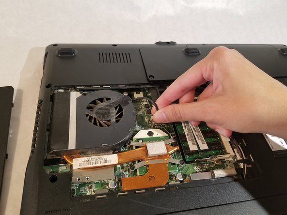

  3. CPU Fan Replacement, CPU Fan: crwdns2935265:03crwdnd2935265:01crwdnd2935265:02crwdne2935265:0 CPU Fan Replacement, CPU Fan: crwdns2935265:03crwdnd2935265:02crwdnd2935265:02crwdne2935265:0
    • Remove the header by pulling on it with two fingers.
  4. CPU Fan Replacement: crwdns2935265:04crwdnd2935265:01crwdnd2935265:01crwdne2935265:0
    • Remove the six 2.5mm screws using a Phillips #1 screwdriver.
  5. CPU Fan Replacement: crwdns2935265:05crwdnd2935265:01crwdnd2935265:01crwdne2935265:0
    • Remove the fan by moving it to the side and lifting it out of the computer.
