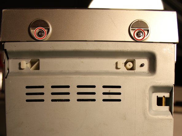

    • Remove the screws
  2. CMT-CP1 Rotary encoder cleaning/replacing, remove flex cables: crwdns2935265:02crwdnd2935265:01crwdnd2935265:01crwdne2935265:0
    • Remove the flex cables with easy access
  3. CMT-CP1 Rotary encoder cleaning/replacing, remove screws: crwdns2935265:03crwdnd2935265:01crwdnd2935265:02crwdne2935265:0 CMT-CP1 Rotary encoder cleaning/replacing, remove screws: crwdns2935265:03crwdnd2935265:02crwdnd2935265:02crwdne2935265:0
    • Remove the screws on both sides and on the bottom

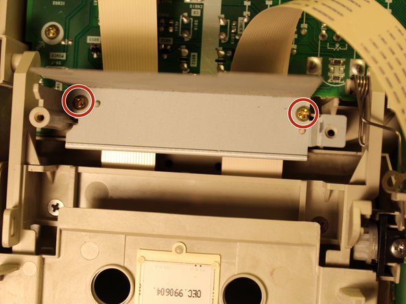

  5. CMT-CP1 Rotary encoder cleaning/replacing, remove cassette deck: crwdns2935265:05crwdnd2935265:01crwdnd2935265:02crwdne2935265:0 CMT-CP1 Rotary encoder cleaning/replacing, remove cassette deck: crwdns2935265:05crwdnd2935265:02crwdnd2935265:02crwdne2935265:0
    • Remove the cassette deck (this is to access the screw beneath it)
  6. CMT-CP1 Rotary encoder cleaning/replacing, remove pcb: crwdns2935265:06crwdnd2935265:01crwdnd2935265:01crwdne2935265:0
    • Remove the screws (you have to remove the casetdeck to access the orange screw)

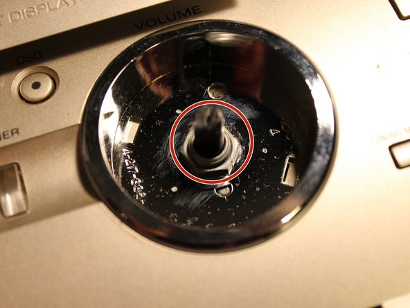

  7. CMT-CP1 Rotary encoder cleaning/replacing, remove knob: crwdns2935265:07crwdnd2935265:01crwdnd2935265:02crwdne2935265:0 CMT-CP1 Rotary encoder cleaning/replacing, remove knob: crwdns2935265:07crwdnd2935265:02crwdnd2935265:02crwdne2935265:0
    • Remove the volume knob and the screw behind it

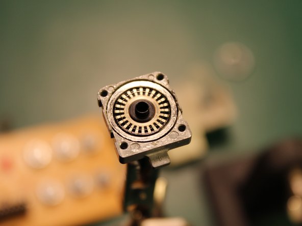

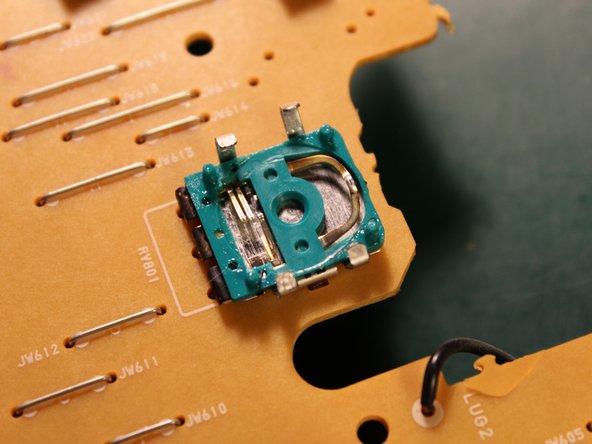

  10. CMT-CP1 Rotary encoder cleaning/replacing, open the rotary encoder: crwdns2935265:010crwdnd2935265:01crwdnd2935265:01crwdne2935265:0
    • Remove the taps to the side carefully
  11. CMT-CP1 Rotary encoder cleaning/replacing, clean the rotary encoder: crwdns2935265:011crwdnd2935265:01crwdnd2935265:03crwdne2935265:0 CMT-CP1 Rotary encoder cleaning/replacing, clean the rotary encoder: crwdns2935265:011crwdnd2935265:02crwdnd2935265:03crwdne2935265:0 CMT-CP1 Rotary encoder cleaning/replacing, clean the rotary encoder: crwdns2935265:011crwdnd2935265:03crwdnd2935265:03crwdne2935265:0
    • clean up your rotary encoder with a screwdriver, also the inside!

Hi Jacco, thanks for this guide. What device is this? As the instructions for disassembly are somewhat specific, this could be interesting. For cleaning the encoder, you seriously recommend to do that using a screwdriver? I find the spring contacts inside these encoders rather delicate typically and they would easily take damage if the wrong tool is used for cleaning. I must recommend to use 1) a lot of care, 2) nothing that is tougher than cotton buds, 3) alcohol, and 4) contact spray eventually to keep things clean and coated against future oxidation. Usually there is no need for scrubbing if contacts are gold plated. Oxidation might be an issue otherwise but that is best removed with chemical anti-oxidation agents, and if that does not help, a (very) soft metal brush, or maybe very fine grain sandpaper, applied with as little pressure as possible of course. A screwdriver will easily scratch surfaces or bend contacts, both of which will cause the encoder to drop out again sooner than later.
