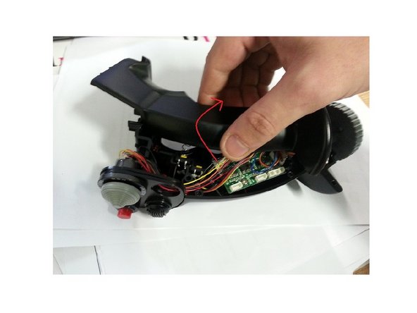

    2. CMS Switch Replacement, Open the handle: crwdns2935265:02crwdnd2935265:01crwdnd2935265:02crwdne2935265:0 CMS Switch Replacement, Open the handle: crwdns2935265:02crwdnd2935265:02crwdnd2935265:02crwdne2935265:0
      • Slowly pull the top half of the stick and rotate it. (Be careful not to damage the wires inside).
      • The red trigger can pop out due to tension from springs, so be careful.

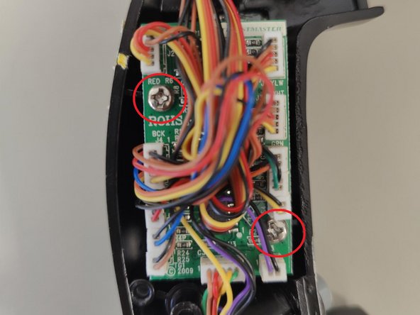

    1. CMS Switch Replacement, Remove the connector: crwdns2935265:04crwdnd2935265:01crwdnd2935265:02crwdne2935265:0 CMS Switch Replacement, Remove the connector: crwdns2935265:04crwdnd2935265:02crwdnd2935265:02crwdne2935265:0
      • Disconnect the wires from CMS connector, they are highlighted in red.
      • Remove the screws so that you could detach the PCB.
    2. CMS Switch Replacement, Remove the old CMS: crwdns2935265:05crwdnd2935265:01crwdnd2935265:01crwdne2935265:0
      • Hold down the CMS clip which will allow you to remove the switch. If necessary, you can force it out or brake it.
      • Once the old CMS is removed, you can insert the new one
