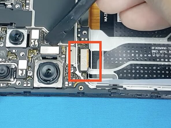

    • First take the SIM card tray out, then you must take the back off the phone by unscrewing all the screws around the case. The case then is removed using a shim to unclip the back by moving around the phone and peeling the back off.
    • Once the back of the phone is off, there is a plastic piece, which i believe houses the NFC and flashlight, take all the screws out of this and dont forget the screw under the white sticker.
    • Remove the battery and the plastic sheet underneath
    • Disconnect the screen ribbon cable highlighted in the picture and prepare to feed this through the phone during the next step:
    • Once this is disconnected you can then do the normal screen replacement process, heat the screen edges and slowly pry the screen off. Its very straight forward once you have disconnected the Ribbon cable
    • Clean up the edges and replace with the new screen and follow the process in reverse.
