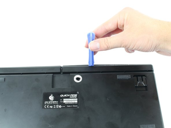

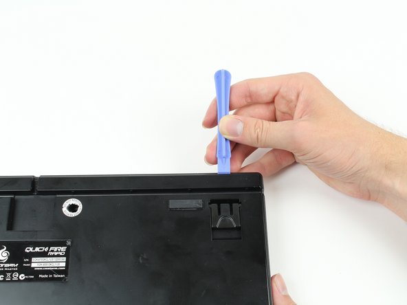

  3. CM Storm QuickFire Rapid Switch Replacement, Seperating Back Panel from Front Panel: crwdns2935265:03crwdnd2935265:01crwdnd2935265:03crwdne2935265:0 CM Storm QuickFire Rapid Switch Replacement, Seperating Back Panel from Front Panel: crwdns2935265:03crwdnd2935265:02crwdnd2935265:03crwdne2935265:0 CM Storm QuickFire Rapid Switch Replacement, Seperating Back Panel from Front Panel: crwdns2935265:03crwdnd2935265:03crwdnd2935265:03crwdne2935265:0
    • Wedge a plastic opening tool between the rear plate and rim of the keyboard and slide it through the circled areas to separate the plastic hooks that mount the rim to the rear plate.

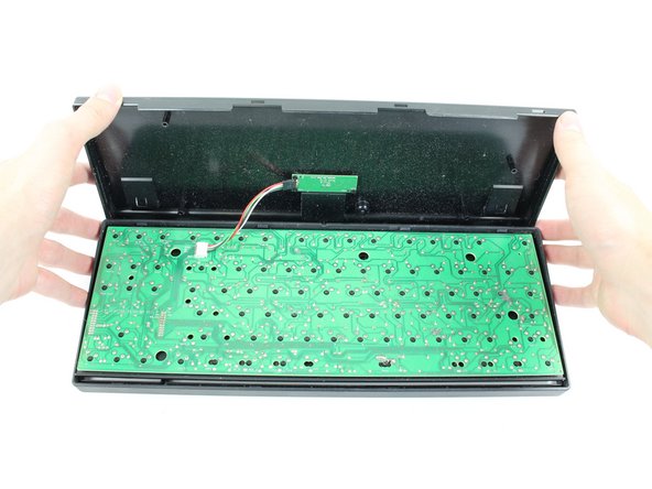

  4. CM Storm QuickFire Rapid Switch Replacement, Opening Back Panel: crwdns2935265:04crwdnd2935265:01crwdnd2935265:02crwdne2935265:0 CM Storm QuickFire Rapid Switch Replacement, Opening Back Panel: crwdns2935265:04crwdnd2935265:02crwdnd2935265:02crwdne2935265:0
    • Firmly grasp the bottom panel of the keyboard and carefully detach it from the rest of the board.
    • Do not put strain on the ribbon cable when lifting the bottom panel.

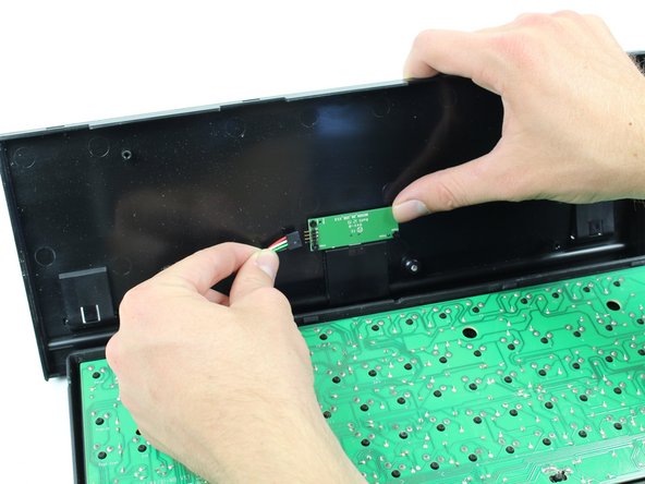

  5. CM Storm QuickFire Rapid Switch Replacement, Detaching SIL Connector: crwdns2935265:05crwdnd2935265:01crwdnd2935265:02crwdne2935265:0 CM Storm QuickFire Rapid Switch Replacement, Detaching SIL Connector: crwdns2935265:05crwdnd2935265:02crwdnd2935265:02crwdne2935265:0
    • Detach the 4-pin cable from the bottom panel of the keyboard.
