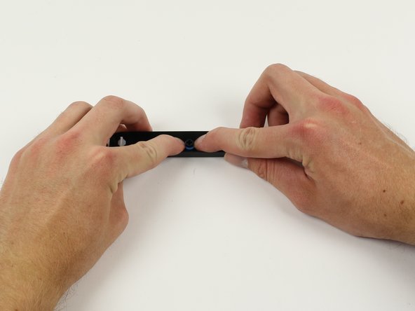

      • Pull the large keycap upward with your fingers until the cap separates from the plastic rings underneath the cap. If the metal bar beneath the cap comes loose during removal, snap it back in place.
