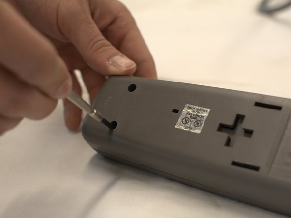

  2. CCI Smart Strip 04941 Teardown: crwdns2935265:02crwdnd2935265:01crwdnd2935265:02crwdne2935265:0 CCI Smart Strip 04941 Teardown: crwdns2935265:02crwdnd2935265:02crwdnd2935265:02crwdne2935265:0
    • Turn Smart Strip upside down and locate four screw holes in corners
    • Unscrew four corner screws with #0 Phillips Screwdriver

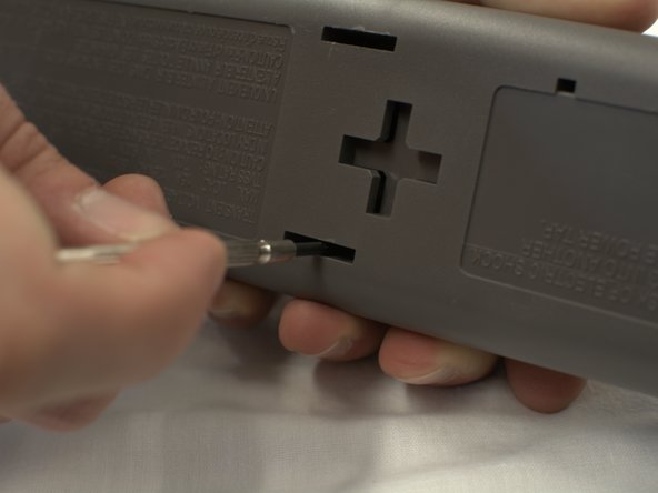

  3. CCI Smart Strip 04941 Teardown: crwdns2935265:03crwdnd2935265:01crwdnd2935265:02crwdne2935265:0 CCI Smart Strip 04941 Teardown: crwdns2935265:03crwdnd2935265:02crwdnd2935265:02crwdne2935265:0
    • Locate four latch slots in case
    • Use 2.4mm Slotted Screwdriver, put tip into center of slot, with tip on outer edge of slot, and press inward

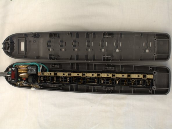

  4. CCI Smart Strip 04941 Teardown: crwdns2935265:04crwdnd2935265:01crwdnd2935265:02crwdne2935265:0 CCI Smart Strip 04941 Teardown: crwdns2935265:04crwdnd2935265:02crwdnd2935265:02crwdne2935265:0
    • Take two halves of case apart with your hands

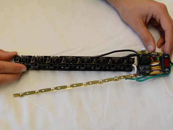

  5. CCI Smart Strip 04941 Teardown: crwdns2935265:05crwdnd2935265:01crwdnd2935265:01crwdne2935265:0
    • Lift Ground Copper Strip upward off of power plugs by hand

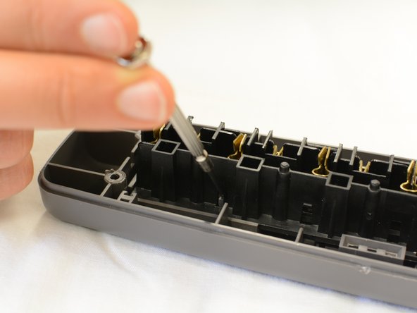

  6. CCI Smart Strip 04941 Teardown: crwdns2935265:06crwdnd2935265:01crwdnd2935265:02crwdne2935265:0 CCI Smart Strip 04941 Teardown: crwdns2935265:06crwdnd2935265:02crwdnd2935265:02crwdne2935265:0
    • Locate latch securing power plugs to bottom of case
    • Using slotted 2.4mm screwdriver, pry latch away from power plugs to loosen power plugs
  7. CCI Smart Strip 04941 Teardown: crwdns2935265:07crwdnd2935265:01crwdnd2935265:02crwdne2935265:0 CCI Smart Strip 04941 Teardown: crwdns2935265:07crwdnd2935265:02crwdnd2935265:02crwdne2935265:0
    • Lift power plugs out of bottom of case along with circuit assembly
