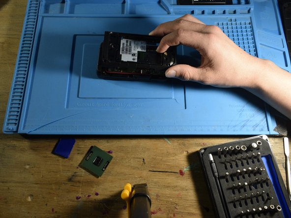

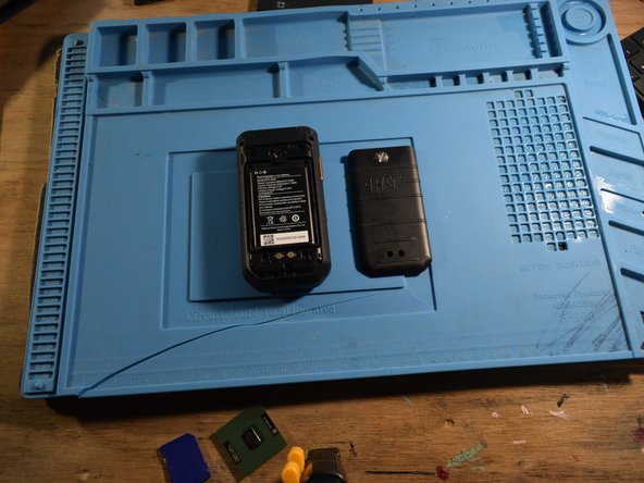

  1. CAT S22 Teardown, the big screw: crwdns2935265:01crwdnd2935265:01crwdnd2935265:02crwdne2935265:0 CAT S22 Teardown, the big screw: crwdns2935265:01crwdnd2935265:02crwdnd2935265:02crwdne2935265:0
    • We first need to take off the back cover and remove the battery. I used a coin to remove the back. its important to keep this screw tight for waterproofing.

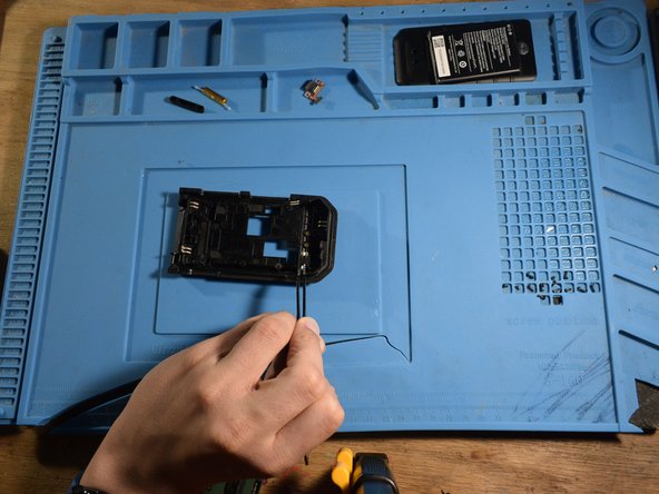

  2. CAT S22 Teardown, Removing the back: crwdns2935265:02crwdnd2935265:01crwdnd2935265:02crwdne2935265:0 CAT S22 Teardown, Removing the back: crwdns2935265:02crwdnd2935265:02crwdnd2935265:02crwdne2935265:0
    • AFTER REMOVING THE SCREWS, THE PHONE WILL NO LONGER BE WATERPROOF. This is because there are tiny gaskets around the screws to ensure its ip68 rating.
    • remove the 12 screws holding on the back. It should come off without any resistance because there is no clips

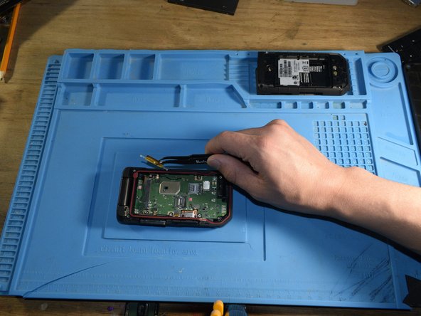

  3. CAT S22 Teardown, remove the vibration motor (optional): crwdns2935265:03crwdnd2935265:01crwdnd2935265:03crwdne2935265:0 CAT S22 Teardown, remove the vibration motor (optional): crwdns2935265:03crwdnd2935265:02crwdnd2935265:03crwdne2935265:0 CAT S22 Teardown, remove the vibration motor (optional): crwdns2935265:03crwdnd2935265:03crwdnd2935265:03crwdne2935265:0
    • after we remove the back we have an optional part to take out. its the vibration motor. use tweezers or your fingers to remove it from the back

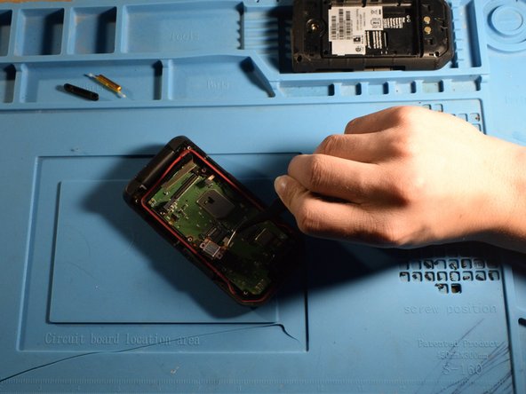

  4. CAT S22 Teardown, a look at the supprisingly modular motherboard: crwdns2935265:04crwdnd2935265:01crwdnd2935265:01crwdne2935265:0
    • wow look at all those connectors. even the usbc is on its own easily replacable board!
    • remove all the connectors marked in blue.

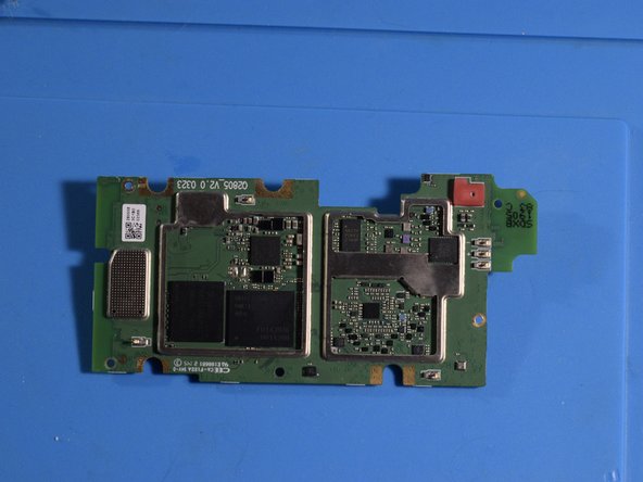

  7. CAT S22 Teardown, remove the mother board: crwdns2935265:07crwdnd2935265:01crwdnd2935265:02crwdne2935265:0 CAT S22 Teardown, remove the mother board: crwdns2935265:07crwdnd2935265:02crwdnd2935265:02crwdne2935265:0
    • just gently lift it up and take it out. after removing the heat shields we get to see the soc and the storage, as well as what I think is the modem.

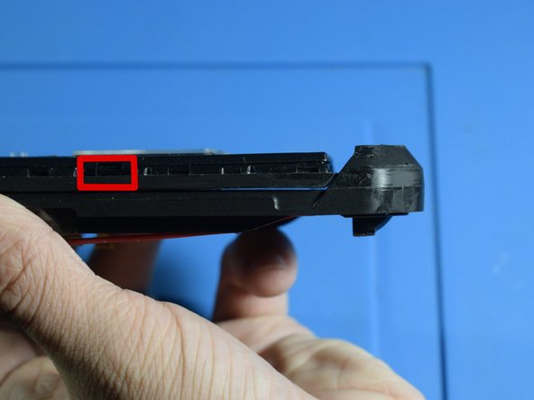

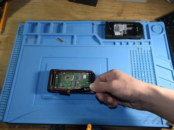

  8. CAT S22 Teardown, removing the front rubber cover.: crwdns2935265:08crwdnd2935265:01crwdnd2935265:02crwdne2935265:0 CAT S22 Teardown, removing the front rubber cover.: crwdns2935265:08crwdnd2935265:02crwdnd2935265:02crwdne2935265:0
    • there is a rubber cover on top of the unit that protects it. removing this shows another set of screws and a hard plastic cover

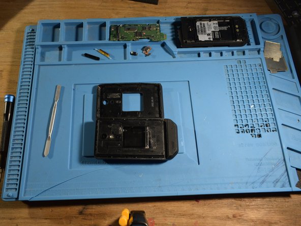

  9. CAT S22 Teardown: crwdns2935265:09crwdnd2935265:01crwdnd2935265:02crwdne2935265:0 CAT S22 Teardown: crwdns2935265:09crwdnd2935265:02crwdnd2935265:02crwdne2935265:0
    • remove the eight screws and the clips on all four sides.
