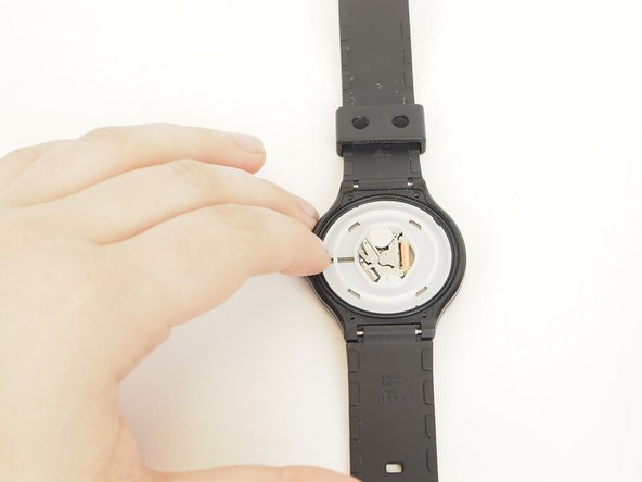

    • Use a Phillips #00 screwdriver to remove the four screws from the back of the watch.
    • Remove the back cover of the watch.
  2. CASIO mw240-1bv Battery Replacement: crwdns2935265:02crwdnd2935265:01crwdnd2935265:03crwdne2935265:0 CASIO mw240-1bv Battery Replacement: crwdns2935265:02crwdnd2935265:02crwdnd2935265:03crwdne2935265:0 CASIO mw240-1bv Battery Replacement: crwdns2935265:02crwdnd2935265:03crwdnd2935265:03crwdne2935265:0
    • Use the tweezers to pull the small metal piece to the right slightly to allow the battery to pop out.
    • Replace battery with a SR626SW watch battery.
    • The battery may spring out very suddenly.
    • If your battery is swollen, handle it with care and dispose of it through an e-waste center or ask an electronics store. Do not dispose of it in the garbage.
  3. CASIO mw240-1bv Battery Replacement: crwdns2935265:03crwdnd2935265:01crwdnd2935265:02crwdne2935265:0 CASIO mw240-1bv Battery Replacement: crwdns2935265:03crwdnd2935265:02crwdnd2935265:02crwdne2935265:0
    • If the rubber seal pops out, realign the rubber seal with the groove along the back face.
