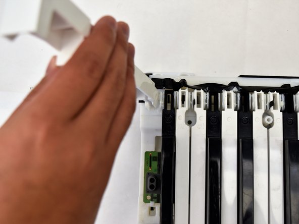

      • Pull up on the white key from the side nearest to you until the key lifts up.
      • Pull up on the two surrounding white keys before pulling up on the black key.
    4. CASIO CDP-230R Key Replacement: crwdns2935265:012crwdnd2935265:01crwdnd2935265:03crwdne2935265:0 CASIO CDP-230R Key Replacement: crwdns2935265:012crwdnd2935265:02crwdnd2935265:03crwdne2935265:0 CASIO CDP-230R Key Replacement: crwdns2935265:012crwdnd2935265:03crwdnd2935265:03crwdne2935265:0
      • Wiggle the white key from side to side and pull up to detach it from the rest of the board.

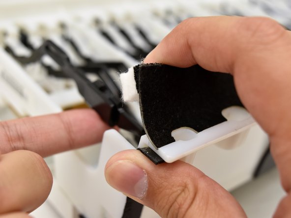

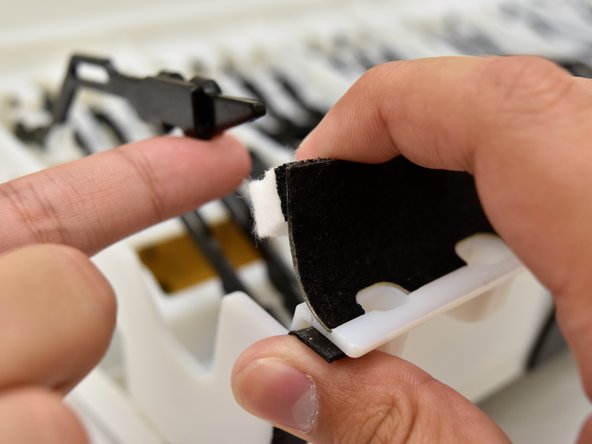

      • To reattach the white key, snap the key back in place.
      • Flip the keyboard so the keys are laying on a flat surface.
      • Pull up on the black and white felt to dislodge the black shank.
      • Push up on the white key while pulling the felt up to reposition the black shank underneath the felt.
