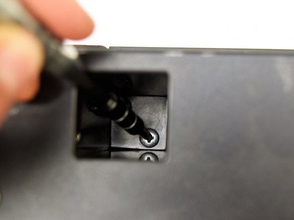

      • Flip the keyboard upside down, with the keys on a flat surface.

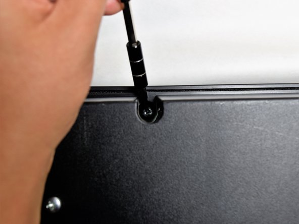

      • Remove the three black 14mm Japanese Industrial Standard (J) head screws using a J1 screwdriver on the top half of the outermost side panel.

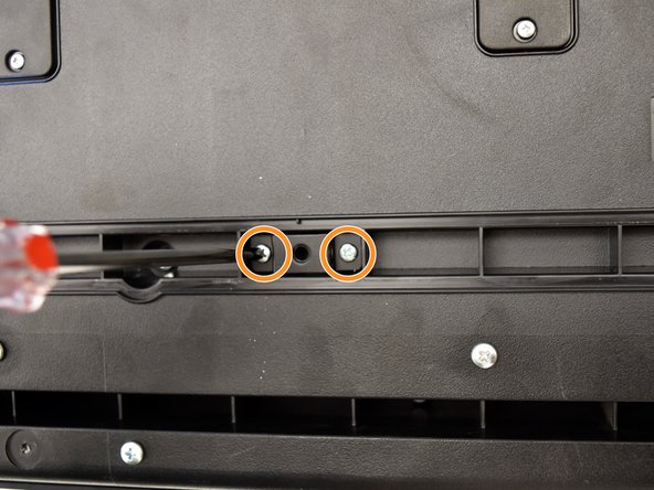

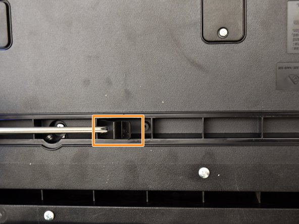

      • Remove the two black 30 mm J head screws with a J1 screwdriver to remove the long black bar.
      • Remove the four silver 8mm x 2mm J head screws with a J1 screwdriver and the two brackets from the back panel.
      • There will be two screws per bracket.

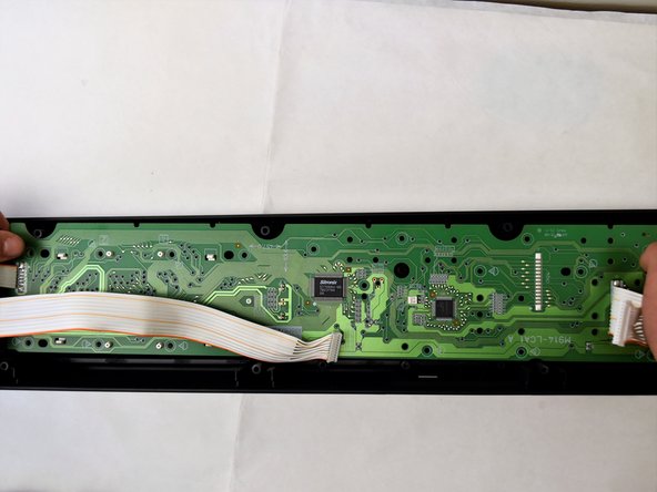

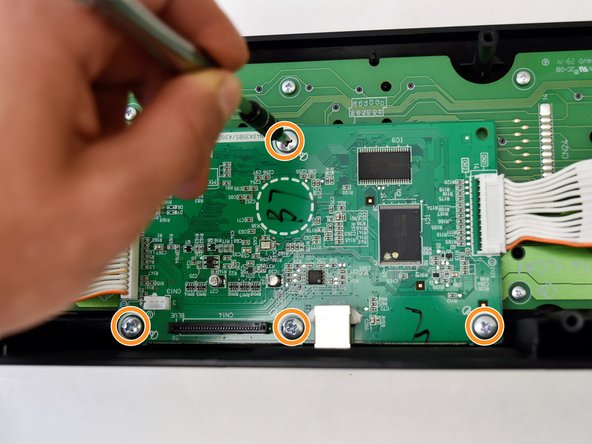

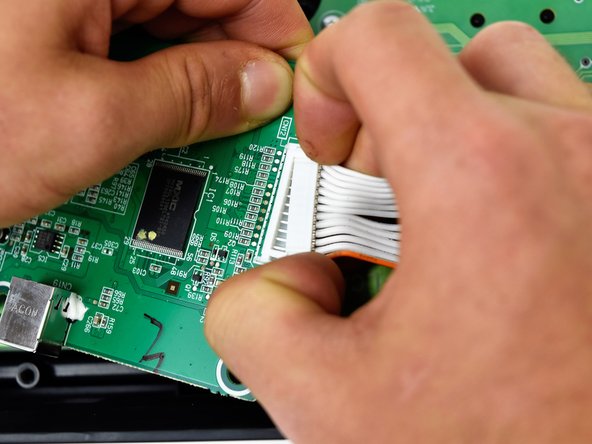

    1. CASIO CDP-230R Button Panel Replacement, Main Circuit Board: crwdns2935265:09crwdnd2935265:01crwdnd2935265:02crwdne2935265:0 CASIO CDP-230R Button Panel Replacement, Main Circuit Board: crwdns2935265:09crwdnd2935265:02crwdnd2935265:02crwdne2935265:0
      • The main circuit board is located on the green side of the button panel. The main circuit board is the smaller green board.
      • Grasp the white ribbon lined with foam and pull up to remove from the main circuit board.
      • Remove the four silver 8mm x 2mm J head screws with a J1 screwdriver.

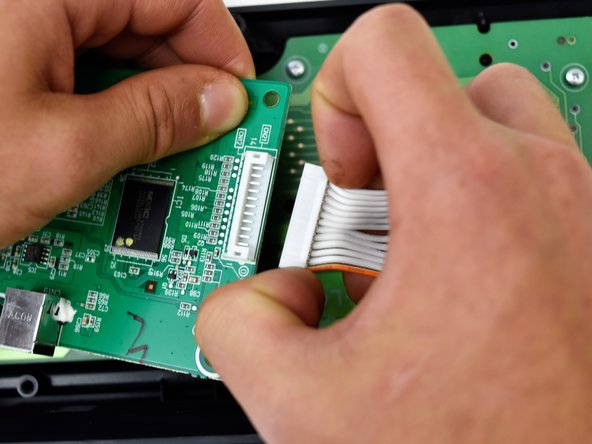

    3. CASIO CDP-230R Button Panel Replacement: crwdns2935265:011crwdnd2935265:01crwdnd2935265:03crwdne2935265:0 CASIO CDP-230R Button Panel Replacement: crwdns2935265:011crwdnd2935265:02crwdnd2935265:03crwdne2935265:0 CASIO CDP-230R Button Panel Replacement: crwdns2935265:011crwdnd2935265:03crwdnd2935265:03crwdne2935265:0
      • Grip the white plastic end of the orange and white cables that is attached to the right side of the main circuit board and pull to the right.
      • Repeat for the orange and white cables attached to the left side of the main circuit board and pull up.

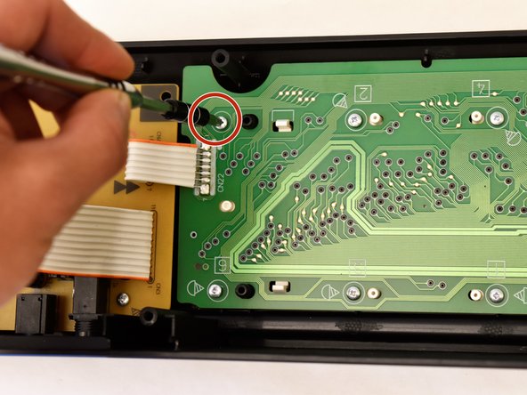

    1. CASIO CDP-230R Button Panel Replacement, Button Panel: crwdns2935265:012crwdnd2935265:01crwdnd2935265:02crwdne2935265:0 CASIO CDP-230R Button Panel Replacement, Button Panel: crwdns2935265:012crwdnd2935265:02crwdnd2935265:02crwdne2935265:0
      • Remove the 11 7.5mm J head screws from the yellow button panel by using a J1 screwdriver.
    2. CASIO CDP-230R Button Panel Replacement: crwdns2935265:013crwdnd2935265:01crwdnd2935265:02crwdne2935265:0 CASIO CDP-230R Button Panel Replacement: crwdns2935265:013crwdnd2935265:02crwdnd2935265:02crwdne2935265:0
      • Remove the 19 9mm J head screws from the green button panel by using a J1 screwdriver.
