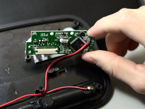

    1. Button Controller Board Replacement, Button Controller Board: crwdns2935265:08crwdnd2935265:01crwdnd2935265:02crwdne2935265:0 Button Controller Board Replacement, Button Controller Board: crwdns2935265:08crwdnd2935265:02crwdnd2935265:02crwdne2935265:0
      • Remove the four 6 mm screws that secure the button controller PCB to the rest of the device; you will need a Phillips #2 driver for this task.
      • Note: Since the main board is on top of this PCB, you may need to move the main board out of the way to access the screws.
      • Lift the PCB away from the rest of the device.
    2. Button Controller Board Replacement: crwdns2935265:09crwdnd2935265:01crwdnd2935265:01crwdne2935265:0
      • Peel away the glue connecting the red and black wire with the PCB board.
    3. Button Controller Board Replacement: crwdns2935265:010crwdnd2935265:01crwdnd2935265:01crwdne2935265:0
      • Using a soldering wick and a soldering iron, remove the solder from the red and black wire ends on the other side of the board.
      • For more information on soldering, refer to iFixit's soldering guide.
