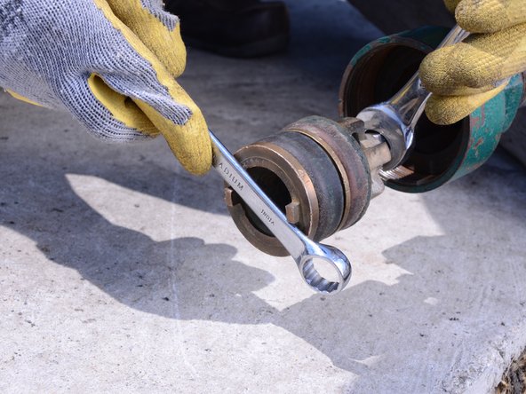

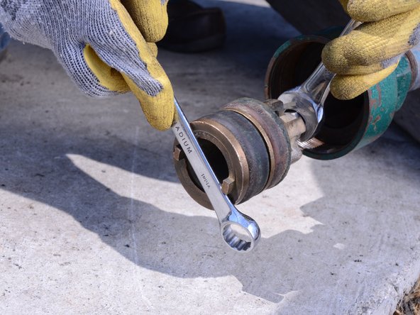

  39. Bush Pump Traveling Valve Replacement, Traveling Valve: crwdns2935265:039crwdnd2935265:01crwdnd2935265:03crwdne2935265:0 Bush Pump Traveling Valve Replacement, Traveling Valve: crwdns2935265:039crwdnd2935265:02crwdnd2935265:03crwdne2935265:0 Bush Pump Traveling Valve Replacement, Traveling Valve: crwdns2935265:039crwdnd2935265:03crwdnd2935265:03crwdne2935265:0
    • Insert a wrench into the slots located at the bottom of the traveling valve.
    • Using another wrench for leverage, unscrew the valve off the pump rod.
  40. Bush Pump Traveling Valve Replacement: crwdns2935265:040crwdnd2935265:01crwdnd2935265:02crwdne2935265:0 Bush Pump Traveling Valve Replacement: crwdns2935265:040crwdnd2935265:02crwdnd2935265:02crwdne2935265:0
    • Unscrew the valve from the pump rod.
  41. Bush Pump Traveling Valve Replacement: crwdns2935265:041crwdnd2935265:01crwdnd2935265:03crwdne2935265:0 Bush Pump Traveling Valve Replacement: crwdns2935265:041crwdnd2935265:02crwdnd2935265:03crwdne2935265:0 Bush Pump Traveling Valve Replacement: crwdns2935265:041crwdnd2935265:03crwdnd2935265:03crwdne2935265:0
    • Be careful to keep the valve parts off the ground.
    • Check the valve components for signs of wear and tear.
  42. Bush Pump Traveling Valve Replacement: crwdns2935265:042crwdnd2935265:01crwdnd2935265:02crwdne2935265:0 Bush Pump Traveling Valve Replacement: crwdns2935265:042crwdnd2935265:02crwdnd2935265:02crwdne2935265:0
    • Remove the poppet from the valve to check for signs of wear.
    • Be sure to take note of the order and direction of the components for reassembly. This is essential, as the pump will not work if the valve is not reinstalled correctly.
