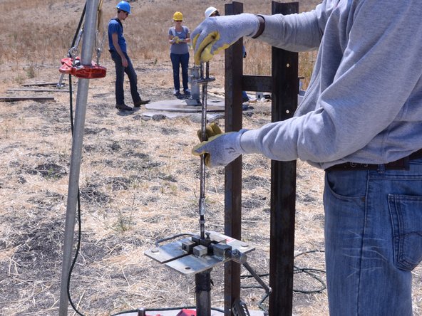

  29. Bush Pump Foot Valve Replacement: crwdns2935265:029crwdnd2935265:01crwdnd2935265:02crwdne2935265:0 Bush Pump Foot Valve Replacement: crwdns2935265:029crwdnd2935265:02crwdnd2935265:02crwdne2935265:0
    • Keep the pipe wrench a few inches above the joint in this step.
    • Using a pipe wrench, unscrew the first section of the riser main from the connection.
  30. Bush Pump Foot Valve Replacement: crwdns2935265:030crwdnd2935265:01crwdnd2935265:03crwdne2935265:0 Bush Pump Foot Valve Replacement: crwdns2935265:030crwdnd2935265:02crwdnd2935265:03crwdne2935265:0 Bush Pump Foot Valve Replacement: crwdns2935265:030crwdnd2935265:03crwdnd2935265:03crwdne2935265:0
    • Secure a splash guard over the joint to prevent water from spraying out of the connection when separated.
    • Using the pipe wrench, loosen the riser main until water begins to spray into the splash guard.
    • Do not loosen it any further until the water has stopped spraying.
  31. Bush Pump Foot Valve Replacement: crwdns2935265:031crwdnd2935265:01crwdnd2935265:03crwdne2935265:0 Bush Pump Foot Valve Replacement: crwdns2935265:031crwdnd2935265:02crwdnd2935265:03crwdne2935265:0 Bush Pump Foot Valve Replacement: crwdns2935265:031crwdnd2935265:03crwdnd2935265:03crwdne2935265:0
    • Remove the splash guard, and finish loosening the riser main.
    • Remove the first section of the riser main by lifting it straight up, while supporting the top of the section and keeping the pipe within the support slot on the top of the tripod.

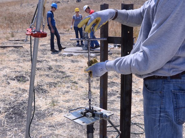

  32. Bush Pump Foot Valve Replacement: crwdns2935265:032crwdnd2935265:01crwdnd2935265:03crwdne2935265:0 Bush Pump Foot Valve Replacement: crwdns2935265:032crwdnd2935265:02crwdnd2935265:03crwdne2935265:0 Bush Pump Foot Valve Replacement: crwdns2935265:032crwdnd2935265:03crwdnd2935265:03crwdne2935265:0
    • Attach and tighten the rod clamp a few inches below the first pump rod connection.
  33. Bush Pump Foot Valve Replacement: crwdns2935265:033crwdnd2935265:01crwdnd2935265:03crwdne2935265:0 Bush Pump Foot Valve Replacement: crwdns2935265:033crwdnd2935265:02crwdnd2935265:03crwdne2935265:0 Bush Pump Foot Valve Replacement: crwdns2935265:033crwdnd2935265:03crwdnd2935265:03crwdne2935265:0
    • Using two crescent wrenches, unscrew the pump rod from the remaining portion.
    • When the joint is separated, carefully lower the riser main to the ground.
  34. Bush Pump Foot Valve Replacement: crwdns2935265:034crwdnd2935265:01crwdnd2935265:03crwdne2935265:0 Bush Pump Foot Valve Replacement: crwdns2935265:034crwdnd2935265:02crwdnd2935265:03crwdne2935265:0 Bush Pump Foot Valve Replacement: crwdns2935265:034crwdnd2935265:03crwdnd2935265:03crwdne2935265:0
    • Carefully lower the riser main, horizontally, and place it in a sanitary place, preferably resting above the ground, to prevent contamination.
  35. Bush Pump Foot Valve Replacement: crwdns2935265:035crwdnd2935265:01crwdnd2935265:03crwdne2935265:0 Bush Pump Foot Valve Replacement: crwdns2935265:035crwdnd2935265:02crwdnd2935265:03crwdne2935265:0 Bush Pump Foot Valve Replacement: crwdns2935265:035crwdnd2935265:03crwdnd2935265:03crwdne2935265:0
    • Remove the T-handle from the separated pump rod.
    • Attach the T-handle to the remaining pump rod.
    • Remove the rod clamp and repeat steps 29-35 until the riser main is completely removed, or until the broken section is reached.
