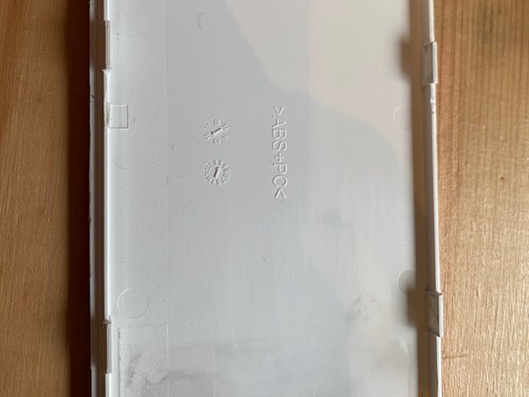

    • Using a thin blade, gently prise the strip-sticker from the front of the unit.
  2. Buffalo Linkstation mini LS-WSXL Disassembly, Splitting the case: crwdns2935265:02crwdnd2935265:01crwdnd2935265:02crwdne2935265:0 Buffalo Linkstation mini LS-WSXL Disassembly, Splitting the case: crwdns2935265:02crwdnd2935265:02crwdnd2935265:02crwdne2935265:0
    • There are two catches to release on the front face.
    • Using the iFixit opening tools, insert the first blade between the long opening and the first hole.
    • The second blade should be inserted between the third and fourth holes
    • Gently manipulate the tools to disengage the catches.
    • Open the case wider to be able to get the ifixit tools in the gap on the side of the unit - go to the next step.
  3. Buffalo Linkstation mini LS-WSXL Disassembly, Removing the lid: crwdns2935265:03crwdnd2935265:01crwdnd2935265:02crwdne2935265:0 Buffalo Linkstation mini LS-WSXL Disassembly, Removing the lid: crwdns2935265:03crwdnd2935265:02crwdnd2935265:02crwdne2935265:0
    • The first catch is next to the rubber foot. Insert the tool under the lip and lift the side to disengage the catch
    • The second catch can be found at the beginning of the vents, use the same technique to open the catch
    • Repeat the steps on the opposite side and the lid will come off.
  4. Buffalo Linkstation mini LS-WSXL Disassembly, Removing the hard drives: crwdns2935265:04crwdnd2935265:01crwdnd2935265:03crwdne2935265:0 Buffalo Linkstation mini LS-WSXL Disassembly, Removing the hard drives: crwdns2935265:04crwdnd2935265:02crwdnd2935265:03crwdne2935265:0 Buffalo Linkstation mini LS-WSXL Disassembly, Removing the hard drives: crwdns2935265:04crwdnd2935265:03crwdnd2935265:03crwdne2935265:0
    • Pull the until out of the case, there are no catches, it is simply held in.
    • Place the unit on it's side and remove the metal plate that is clamped to the board.
    • Turn the unit over the remove the second plate.
    • The hard drives can now be removed.
  5. Buffalo Linkstation mini LS-WSXL Disassembly, Finished!: crwdns2935265:05crwdnd2935265:01crwdnd2935265:02crwdne2935265:0 Buffalo Linkstation mini LS-WSXL Disassembly, Finished!: crwdns2935265:05crwdnd2935265:02crwdnd2935265:02crwdne2935265:0
    • The unit is now disassembled, assembly is simply done in the reverse order.
    • When reassembling the unit, pay attention to the orientation of the metal plates.
