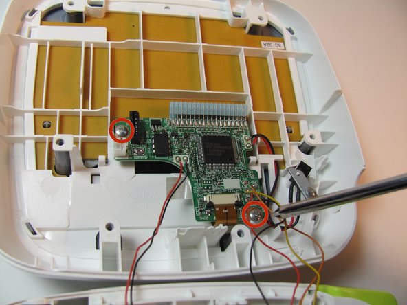

    1. Brother PT-D200 LCD Screen Replacement, Circuit Board: crwdns2935265:07crwdnd2935265:01crwdnd2935265:02crwdne2935265:0 Brother PT-D200 LCD Screen Replacement, Circuit Board: crwdns2935265:07crwdnd2935265:02crwdnd2935265:02crwdne2935265:0
      • Remove the two 3/16" screws from the circuit board using the Helping Hand 1/4" screwdriver.

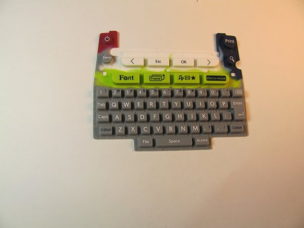

    1. Brother PT-D200 LCD Screen Replacement, Keyboard: crwdns2935265:012crwdnd2935265:01crwdnd2935265:02crwdne2935265:0 Brother PT-D200 LCD Screen Replacement, Keyboard: crwdns2935265:012crwdnd2935265:02crwdnd2935265:02crwdne2935265:0
      • Peel off the rubber keyboard of the device.

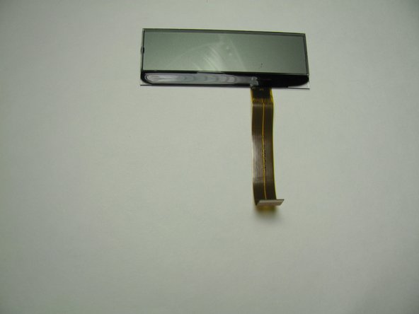

    1. Brother PT-D200 LCD Screen Replacement, LCD Screen: crwdns2935265:013crwdnd2935265:01crwdnd2935265:02crwdne2935265:0 Brother PT-D200 LCD Screen Replacement, LCD Screen: crwdns2935265:013crwdnd2935265:02crwdnd2935265:02crwdne2935265:0
      • Lift the LCD screen out of place.
