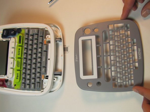

  7. Brother PT-D200 Faceplate Replacement, Face Plate: crwdns2935265:07crwdnd2935265:01crwdnd2935265:01crwdne2935265:0
    • On the top portion of the device there are four grey clips locking the faceplate in place. The two top clips are circled in the image. The two others are located in the other corners of the device.
  8. Brother PT-D200 Faceplate Replacement: crwdns2935265:08crwdnd2935265:01crwdnd2935265:02crwdne2935265:0 Brother PT-D200 Faceplate Replacement: crwdns2935265:08crwdnd2935265:02crwdnd2935265:02crwdne2935265:0
    • Pull the clips inward two at a time, first the top then the bottom, to snap the face plate off.
