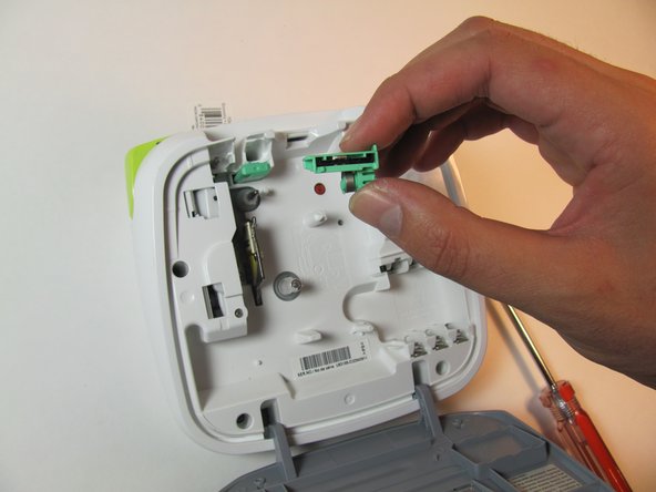

      • Open the back panel of the device by pressing down on and then pulling the indication arrows on the top center of the cover upward towards you.
    2. Brother PT-D200 Cutter Blade Replacement: crwdns2935265:02crwdnd2935265:01crwdnd2935265:01crwdne2935265:0
      • Locate the cutter blade unit (mint green) as shown in the picture.
    3. Brother PT-D200 Cutter Blade Replacement: crwdns2935265:03crwdnd2935265:01crwdnd2935265:02crwdne2935265:0 Brother PT-D200 Cutter Blade Replacement: crwdns2935265:03crwdnd2935265:02crwdnd2935265:02crwdne2935265:0
      • Using the thumb and forefinger, pull up, applying a moderate amount of pressure until the cutter blade unit loosens and is removed.
      • The blade is sharp.

Where can you order the replacement blade?
mistymeziere - crwdns2934203:0crwdne2934203:0 crwdns2950251:0crwdne2950251:0
Thank you it, the blade came out and I did not know how to fix this.. found this video and quickly fixed it..
