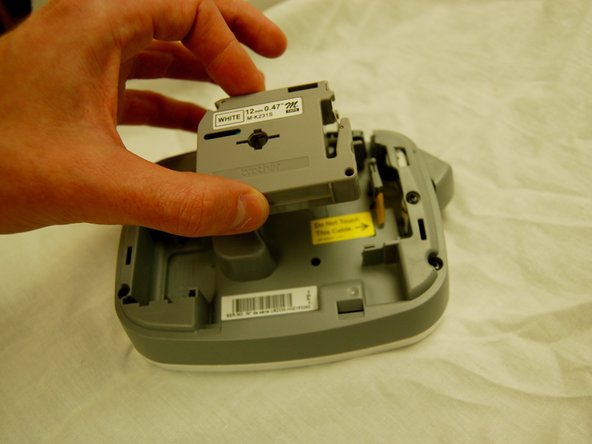

    • Start with your device off. The screen should be blank and not displaying anything.
    • Turn the device over so it's resting face down.
    • You should be able to see the model name of the label-maker, as well as a window in which you can view the label cartridge.

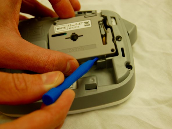

  3. Brother PT-90 Personal Labeler Disassembly: crwdns2935265:03crwdnd2935265:01crwdnd2935265:03crwdne2935265:0 Brother PT-90 Personal Labeler Disassembly: crwdns2935265:03crwdnd2935265:02crwdnd2935265:03crwdne2935265:0 Brother PT-90 Personal Labeler Disassembly: crwdns2935265:03crwdnd2935265:03crwdnd2935265:03crwdne2935265:0
    • To remove the label cartridge from the device, use a plastic opening tool from your iFixit tool kit.

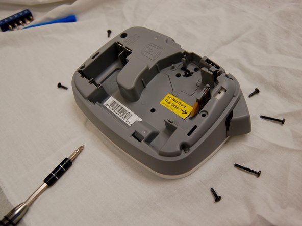

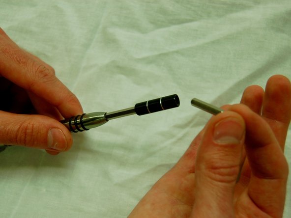

    • Attach the J1 Screwdriver Bit to the extension tool from your tool kit.
    • Remove all of the screws from the back of the device.

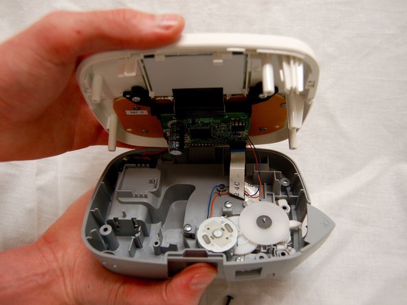

  5. Brother PT-90 Personal Labeler Disassembly: crwdns2935265:05crwdnd2935265:01crwdnd2935265:02crwdne2935265:0 Brother PT-90 Personal Labeler Disassembly: crwdns2935265:05crwdnd2935265:02crwdnd2935265:02crwdne2935265:0
    • Once the screws have been removed, press as shown on the fastener.
    • Carefully open the device.
