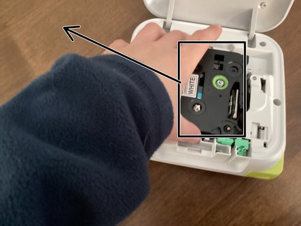

      • Use the tab to open the back cover of your machine.
    1. Brother PT-210 Tape Replacement, Tape: crwdns2935265:02crwdnd2935265:01crwdnd2935265:02crwdne2935265:0 Brother PT-210 Tape Replacement, Tape: crwdns2935265:02crwdnd2935265:02crwdnd2935265:02crwdne2935265:0
      • Remove the tape by grabbing the tape and pulling it up & out of your machine.
    2. Brother PT-210 Tape Replacement, New Tape: crwdns2935265:03crwdnd2935265:01crwdnd2935265:01crwdne2935265:0
      • If you are going to use a new tape, you have to turn the green knob counterclockwise a few times to get the tape ready to use.
