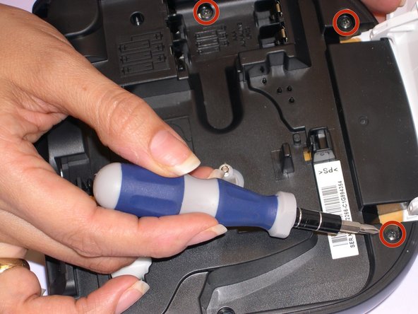

    • Remove all 1/4 inch screws(6 total) with a (+PH00) screwdriver. Open slowly not to damage the display data cable.

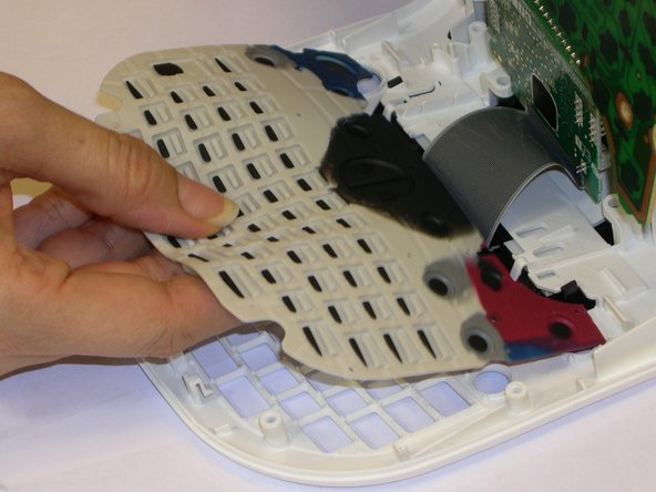

    • Use a plastic opening tool to remove the flat-panel membrane keyboard. Lift up and set aside.
  10. Brother PT-1290 LCD Screen Replacement: crwdns2935265:010crwdnd2935265:01crwdnd2935265:03crwdne2935265:0 Brother PT-1290 LCD Screen Replacement: crwdns2935265:010crwdnd2935265:02crwdnd2935265:03crwdne2935265:0 Brother PT-1290 LCD Screen Replacement: crwdns2935265:010crwdnd2935265:03crwdnd2935265:03crwdne2935265:0
    • Use a spudger to aid in removing the keyboard.
    • Gently lift out while removing the LCD screen that is connected to the data cable and finishing removing.

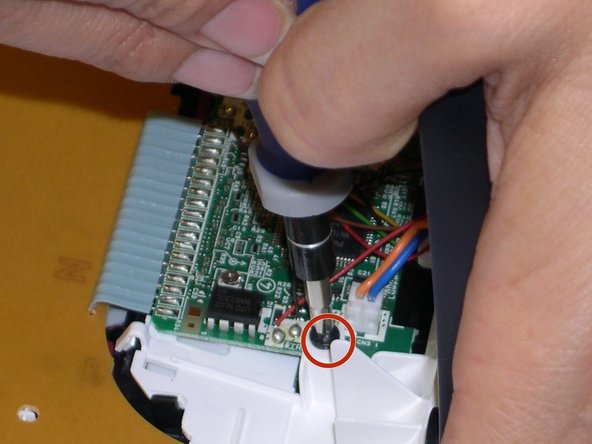

    • Remove the five screws that secure the plate using a Phillips #00 screwdriver.
    • One screw has a very narrow access; you will need a thinner screwdriver.

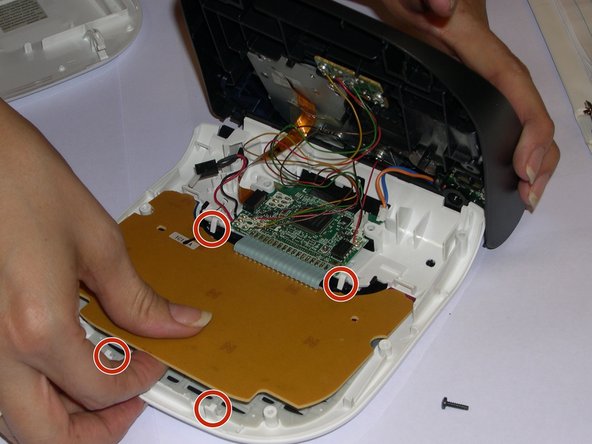

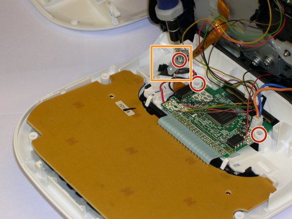

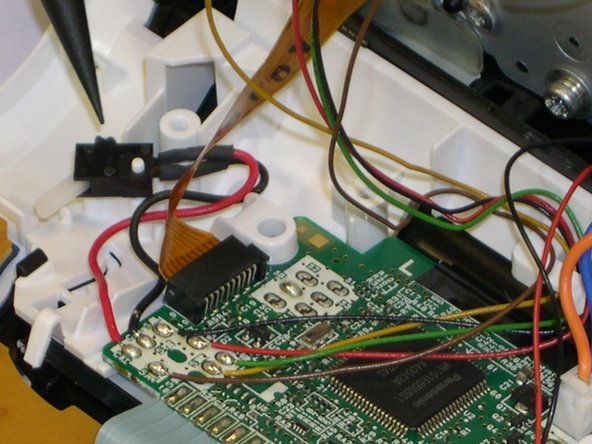

    • Remove three screws to be able to lift the keyboard.
    • Remove the small metal plate on top of the black connector with the red and black cables.
  13. Brother PT-1290 LCD Screen Replacement: crwdns2935265:013crwdnd2935265:01crwdnd2935265:02crwdne2935265:0 Brother PT-1290 LCD Screen Replacement: crwdns2935265:013crwdnd2935265:02crwdnd2935265:02crwdne2935265:0

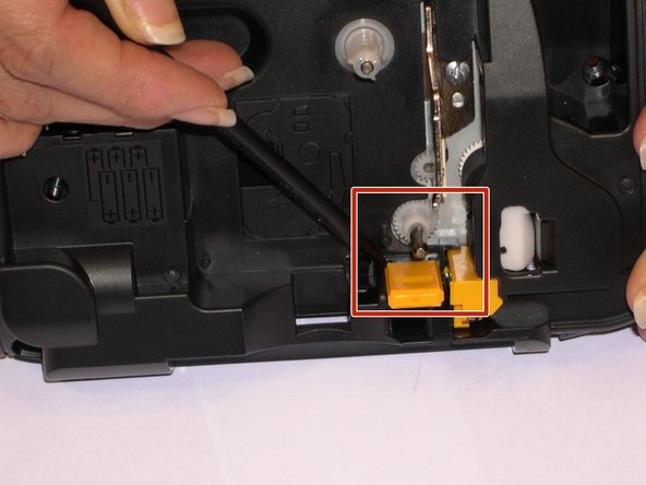

    • Unhook the connector with the orange and blue wire.
    • There is also a hook that holds the yellow, red, orange and green cables; the spudger will be all you need to slide them out to unhook them.
    • The black connector with the red and black cables has to be removed as well.
  14. Brother PT-1290 LCD Screen Replacement: crwdns2935265:014crwdnd2935265:01crwdnd2935265:03crwdne2935265:0 Brother PT-1290 LCD Screen Replacement: crwdns2935265:014crwdnd2935265:02crwdnd2935265:03crwdne2935265:0 Brother PT-1290 LCD Screen Replacement: crwdns2935265:014crwdnd2935265:03crwdnd2935265:03crwdne2935265:0

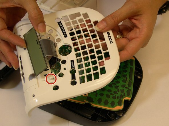

    • Hold the keyboard, making sure the four hooks are properly loose to avoid breaking them.
    • Pull it out gently but firmly.
    • Make sure once it becomes loose, you can proceed to remove the LCD which is being held by two more hooks marked with orange circles. You will need the Spudger to hold them back while pulling the screen with your other hand.
  15. Brother PT-1290 LCD Screen Replacement: crwdns2935265:015crwdnd2935265:01crwdnd2935265:03crwdne2935265:0 Brother PT-1290 LCD Screen Replacement: crwdns2935265:015crwdnd2935265:02crwdnd2935265:03crwdne2935265:0 Brother PT-1290 LCD Screen Replacement: crwdns2935265:015crwdnd2935265:03crwdnd2935265:03crwdne2935265:0
    • If the face plate doesn't get removed, it will be close to impossible to remove the LCD or you'll find yourself breaking some of the hooks that are holding it on place.
    • Remove and replace the LCD screen making sure the display data cable doesn't get damaged in the process.
    • Follow the steps backwards in the order they were removed, to be able to put the parts together and remain your printing job.
