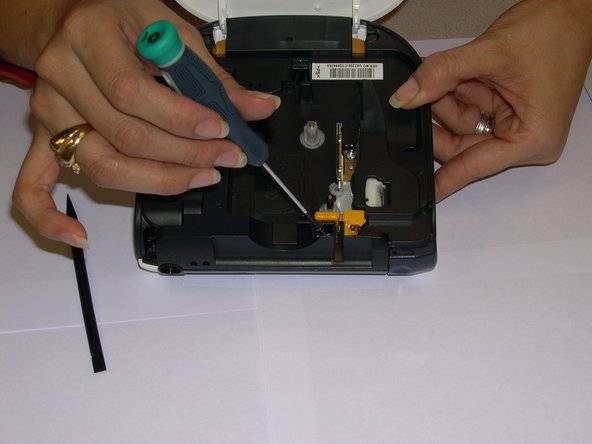

    • Turn the device to its side toward the bottom of the keyboard. Then pop open the case and remove the batteries.
  2. Brother PT-1290  Face Plate Replacement: crwdns2935265:02crwdnd2935265:01crwdnd2935265:03crwdne2935265:0 Brother PT-1290  Face Plate Replacement: crwdns2935265:02crwdnd2935265:02crwdnd2935265:03crwdne2935265:0 Brother PT-1290  Face Plate Replacement: crwdns2935265:02crwdnd2935265:03crwdnd2935265:03crwdne2935265:0

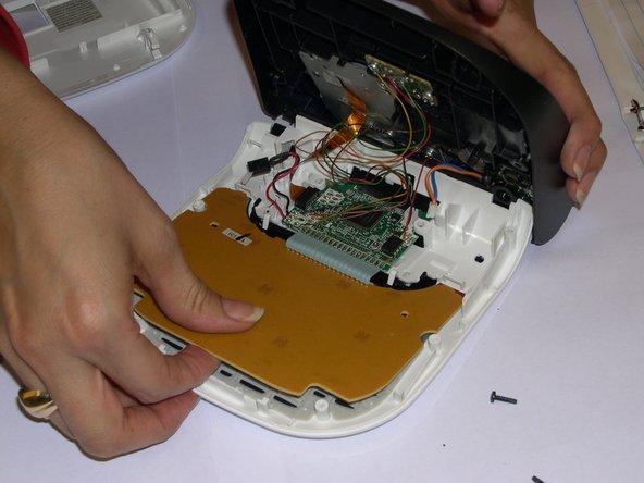

    • Remove back of device and set aside.
  3. Brother PT-1290  Face Plate Replacement: crwdns2935265:03crwdnd2935265:01crwdnd2935265:03crwdne2935265:0 Brother PT-1290  Face Plate Replacement: crwdns2935265:03crwdnd2935265:02crwdnd2935265:03crwdne2935265:0 Brother PT-1290  Face Plate Replacement: crwdns2935265:03crwdnd2935265:03crwdnd2935265:03crwdne2935265:0
    • Remove all 1/4 inch screws(6 total) with a (+PH00) screwdriver. Open slowly not to damage the display data cable.

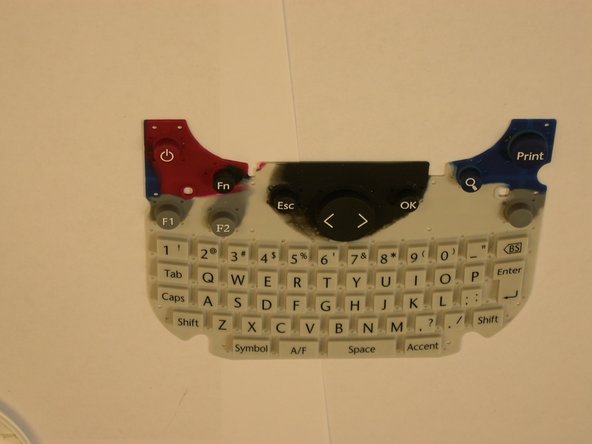

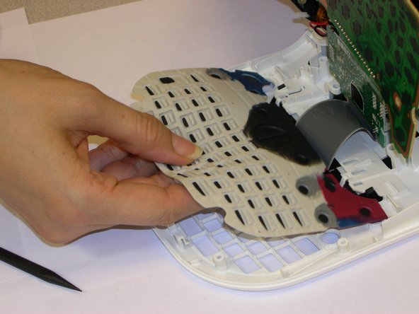

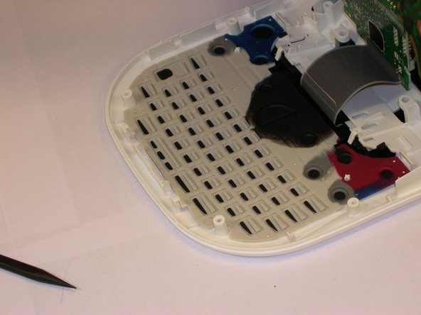

  4. Brother PT-1290  Face Plate Replacement: crwdns2935265:04crwdnd2935265:01crwdnd2935265:03crwdne2935265:0 Brother PT-1290  Face Plate Replacement: crwdns2935265:04crwdnd2935265:02crwdnd2935265:03crwdne2935265:0 Brother PT-1290  Face Plate Replacement: crwdns2935265:04crwdnd2935265:03crwdnd2935265:03crwdne2935265:0
    • Use a plastic opening tool to remove the flat-panel membrane keyboard. Lift up and set aside.
  5. Brother PT-1290  Face Plate Replacement: crwdns2935265:05crwdnd2935265:01crwdnd2935265:03crwdne2935265:0 Brother PT-1290  Face Plate Replacement: crwdns2935265:05crwdnd2935265:02crwdnd2935265:03crwdne2935265:0 Brother PT-1290  Face Plate Replacement: crwdns2935265:05crwdnd2935265:03crwdnd2935265:03crwdne2935265:0
    • Use a spudger to aid in removing the keyboard.
    • Gently lift out while removing the LCD screen that is connected to the data cable and finishing removing.

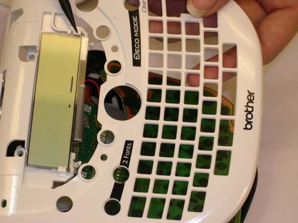

  6. Brother PT-1290  Face Plate Replacement, Removing the LCD screen.: crwdns2935265:06crwdnd2935265:01crwdnd2935265:03crwdne2935265:0 Brother PT-1290  Face Plate Replacement, Removing the LCD screen.: crwdns2935265:06crwdnd2935265:02crwdnd2935265:03crwdne2935265:0 Brother PT-1290  Face Plate Replacement, Removing the LCD screen.: crwdns2935265:06crwdnd2935265:03crwdnd2935265:03crwdne2935265:0
    • Now that you have removed your keyboard. Turn the device over carefully.
    • Pop of LCD black cover.
    • Use the spudger to gently press out the LCD screen.

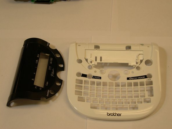

  7. Brother PT-1290  Face Plate Replacement, Switching out faceplate.: crwdns2935265:07crwdnd2935265:01crwdnd2935265:01crwdne2935265:0
    • Change out old damaged face plate with your new face plate.
