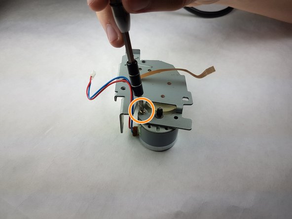

  10. Brother PT-110 Printer Motor Replacement: crwdns2935265:010crwdnd2935265:01crwdnd2935265:02crwdne2935265:0 Brother PT-110 Printer Motor Replacement: crwdns2935265:010crwdnd2935265:02crwdnd2935265:02crwdne2935265:0
    • Unscrew the two 3 mm Phillips #1 screws from the motor housing.
    • Total: 2 x Screws
  11. Brother PT-110 Printer Motor Replacement: crwdns2935265:011crwdnd2935265:01crwdnd2935265:01crwdne2935265:0
    • Remove the motor.
