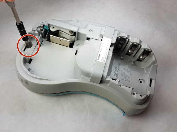

      • Remove the cartridge and the yellow tape cutter.
      • Unscrew the two 9 mm Phillips #1 screws from the top and bottom.
      • Total: 2 x Screws

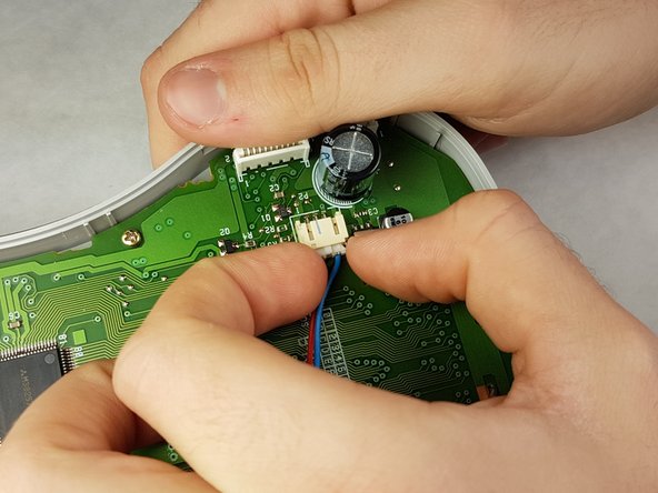

      • Carefully pinch the top of the connector.
      • Pull perpendicular to the device until the wire is disconnected. Remove the other connector by pulling it parallel to the circuit board.
      • It may require more force than expected to disconnect the wires.

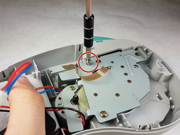

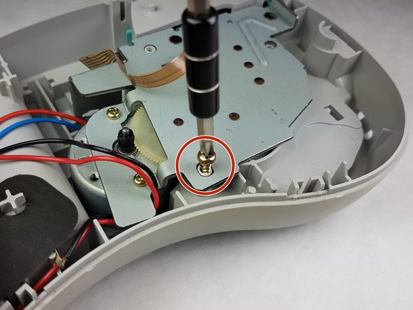

      • Unscrew the three 9 mm Phillips #1 screws shown.
      • Total: 3 x Screws
      • Lift the metal plate upwards, don't unscrew the motor, this will remain attached to the plate. If you didn't remove the yellow tape cutter then it will simply fall out.

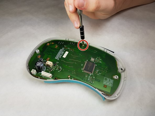

      • Unscrew both 6 mm Phillips #1 screws from the circuit board.
      • Total screws: 2
    2. Brother PT-110 Keypad Contacts Replacement: crwdns2935265:010crwdnd2935265:01crwdnd2935265:01crwdne2935265:0
      • Gently lift the circuit board out.
