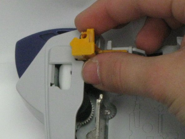

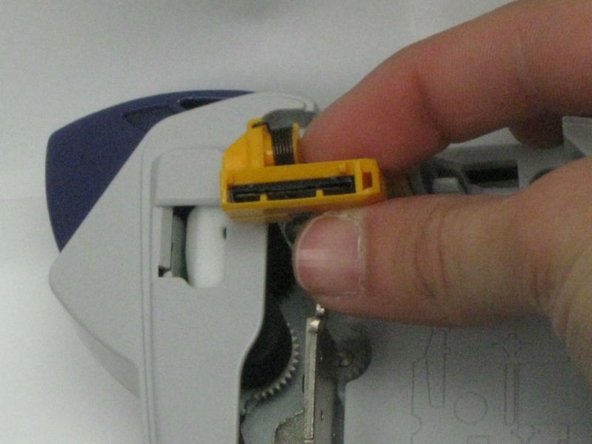

    3. Brother PT-1010 Cutter Blade Replacement, Remove Cutter Blade: crwdns2935265:03crwdnd2935265:01crwdnd2935265:03crwdne2935265:0 Brother PT-1010 Cutter Blade Replacement, Remove Cutter Blade: crwdns2935265:03crwdnd2935265:02crwdnd2935265:03crwdne2935265:0 Brother PT-1010 Cutter Blade Replacement, Remove Cutter Blade: crwdns2935265:03crwdnd2935265:03crwdnd2935265:03crwdne2935265:0
      • Using your thumb and forefinger, pull up, applying a small amount of pressure until the blade loosens and comes out.
      • Be very careful when pulling out the cutter blade, it is very sharp.
      • The Brother no. TL 5 Cutter Blade Unit is required for replacement.
