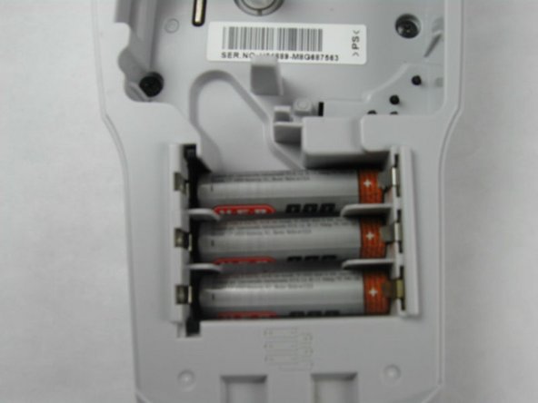

The Brother PT-1010 requires 6-AAA batteries. The batteries are organized in two layers one on top of the other. This guide will inform you on proper battery replacement.
    1. Brother PT-1010 Battery Replacement, Removing Back Panel: crwdns2935265:01crwdnd2935265:01crwdnd2935265:01crwdne2935265:0
      • Turn device so you are looking down at the top
    2. Brother PT-1010 Battery Replacement: crwdns2935265:02crwdnd2935265:01crwdnd2935265:02crwdne2935265:0 Brother PT-1010 Battery Replacement: crwdns2935265:02crwdnd2935265:02crwdnd2935265:02crwdne2935265:0
      • Press firmly on arrow indicator and pull panel toward you.
    3. Brother PT-1010 Battery Replacement, Remove Dead Batteries: crwdns2935265:03crwdnd2935265:01crwdnd2935265:01crwdne2935265:0
      • Remove dead batteries one at a time by pulling up on the side indicated with a + symbol.
      • Make sure the battery compartment is empty and clear of debris.
    4. Brother PT-1010 Battery Replacement: crwdns2935265:04crwdnd2935265:01crwdnd2935265:02crwdne2935265:0 Brother PT-1010 Battery Replacement: crwdns2935265:04crwdnd2935265:02crwdnd2935265:02crwdne2935265:0
      • Insert the first battery with the flat side (indicated by a - symbol on the battery) facing to the left of the battery compartment.
      • Do the same thing to insert the next 2 batteries.
    5. Brother PT-1010 Battery Replacement: crwdns2935265:05crwdnd2935265:01crwdnd2935265:01crwdne2935265:0
      • The next 3 batteries will be inserted on top of the others.
      • Insert the 4th battery with the flat side (indicated by the - symbol on the battery) facing to the right of the battery compartment.
    6. Brother PT-1010 Battery Replacement: crwdns2935265:06crwdnd2935265:01crwdnd2935265:01crwdne2935265:0
      • Repeat step 5 to insert the last 2 batteries.
    7. Brother PT-1010 Battery Replacement, Replace Back Panel: crwdns2935265:07crwdnd2935265:01crwdnd2935265:01crwdne2935265:0
      • Reinsert back panel.
