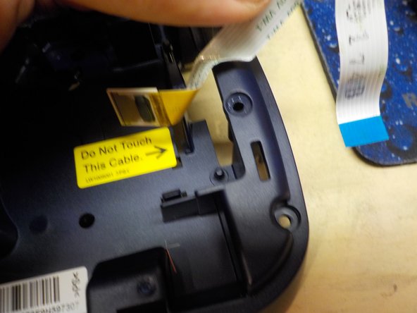

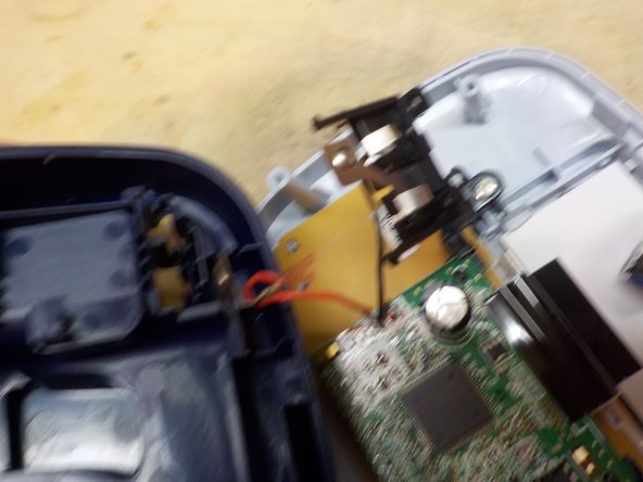

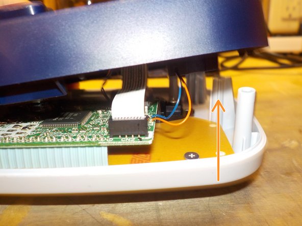

    • Lift the midframe SLOWLY as there are 2 sets of wires and a flex cable connected. Unfortunately, the 2 sets of wires are soldered to the board. Just carefully unplug the flex cable using tweezers, needle nose pliers, or your fingers, whichever you prefer.
    • The 2 sets of wires go to the motor in the unit and the battery bay. The motor just fell out and stayed attached to the circuit board during this teardown. You could desolder the wires, but I didn't end up needing to.

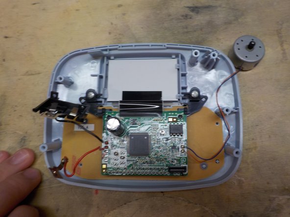

  6. Brother P-Touch PT-M95 Teardown, Main logic board: crwdns2935265:06crwdnd2935265:01crwdnd2935265:02crwdne2935265:0 Brother P-Touch PT-M95 Teardown, Main logic board: crwdns2935265:06crwdnd2935265:02crwdnd2935265:02crwdne2935265:0
    • This is the main working pieces of the whole thing. You will see the following parts inside:
    • Screen (custom monochrome thing, soldered to board)
    • Keyboard. Membrane below.
    • Unknown chip of some kind on the main logic board that I assume is the CPU
    • Flex cable connector for the tape reader thing I mentioned last step.
    • Motor
    • Battery connections.

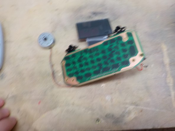

  7. Brother P-Touch PT-M95 Teardown, Removing the main logic board: crwdns2935265:07crwdnd2935265:01crwdnd2935265:03crwdne2935265:0 Brother P-Touch PT-M95 Teardown, Removing the main logic board: crwdns2935265:07crwdnd2935265:02crwdnd2935265:03crwdne2935265:0 Brother P-Touch PT-M95 Teardown, Removing the main logic board: crwdns2935265:07crwdnd2935265:03crwdnd2935265:03crwdne2935265:0
    • The 2 screws next to the display are P1, while the 1 on the keyboard is a P00, all Phillips. Go ahead and remove these now. Don't lift the parts out first though, as the screen is clipped in place.
    • Make sure to press the clip to the left of the screen to lift it out. Don't try to pry it up. It can be damaged quite easily.
    • After you have removed the screen, the board can be lifted out, minding the screen and motor attached.

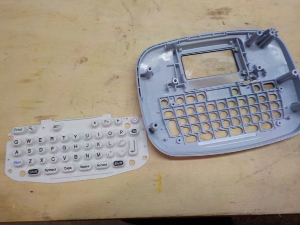

    • Finally, the keyboard membrane can be removed by carefully bending the metal retaining thing out of the way and then lifting the rubber membrane straight out.
