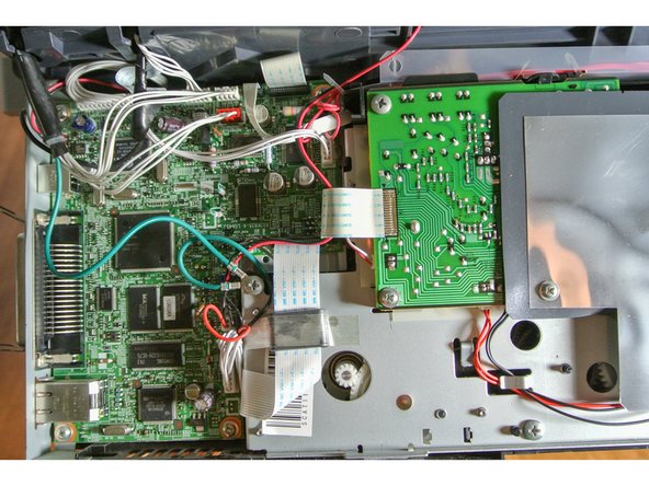

    • To remove the cover from the side where the internal cables are pluged in and the motherboard is located, follow these steps:
    • Raise the upper cover (not the automated document feed). I mean the cover benath the scanner glas.
    • Now turn the side to you, where you've already removed the screws from.
    • The side cover is held by some Hooks, so it can be a bit tricky. Start from the right ro remove the cover. Lift up the darker grey plastic parts slightly.
  4. Brother MFC-7820N Disassembly, Open the side cover II: crwdns2935265:04crwdnd2935265:01crwdnd2935265:03crwdne2935265:0 Brother MFC-7820N Disassembly, Open the side cover II: crwdns2935265:04crwdnd2935265:02crwdnd2935265:03crwdne2935265:0 Brother MFC-7820N Disassembly, Open the side cover II: crwdns2935265:04crwdnd2935265:03crwdnd2935265:03crwdne2935265:0
    • After you fully removed the cover, you'll have a view on the motherboard, the cable and the plugs.
  5. Brother MFC-7820N Disassembly, Remove Automated Document Feed I: crwdns2935265:05crwdnd2935265:01crwdnd2935265:03crwdne2935265:0 Brother MFC-7820N Disassembly, Remove Automated Document Feed I: crwdns2935265:05crwdnd2935265:02crwdnd2935265:03crwdne2935265:0 Brother MFC-7820N Disassembly, Remove Automated Document Feed I: crwdns2935265:05crwdnd2935265:03crwdnd2935265:03crwdne2935265:0
    • To change or remove the ADF-Scanner-Unit, you'll have to remove the cables I've marked in the first picture.

I used this guide to open up the printer and replace the network interface card. Just do everything up to Step 4, then
* unscrew the two screws on the back that secure the parallel printer port
* unplug all cables (take some pictures first, so you remember where each cable goes)
* unscrew the four (or in my case, five) screws that secure the card in place
* the card can then be carefully worked free
Suggestions for Step 3:
* Use a plastic spudger to work the top of the side cover free
* Take care with the plastic tab on the lower right (front of machine) so that you don't break it when pulling off the cover
