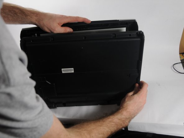

  5. Brother MFC-490CW Scanning Glass Replacement, Exposing scanner glass: crwdns2935265:05crwdnd2935265:01crwdnd2935265:03crwdne2935265:0 Brother MFC-490CW Scanning Glass Replacement, Exposing scanner glass: crwdns2935265:05crwdnd2935265:02crwdnd2935265:03crwdne2935265:0 Brother MFC-490CW Scanning Glass Replacement, Exposing scanner glass: crwdns2935265:05crwdnd2935265:03crwdnd2935265:03crwdne2935265:0
    • To separate the base from the glass hold upright and separate along the edge where you removed the screws.
    • Use hands to expose the glass.
    • Keep track flat once glass is removed as to not lose little parts.
