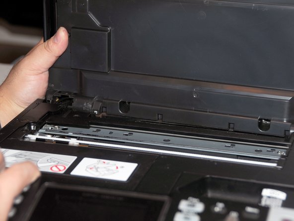

  3. Brother MFC-490CW Print head Replacement, Separate the arm holding scanner unit: crwdns2935265:03crwdnd2935265:01crwdnd2935265:03crwdne2935265:0 Brother MFC-490CW Print head Replacement, Separate the arm holding scanner unit: crwdns2935265:03crwdnd2935265:02crwdnd2935265:03crwdne2935265:0 Brother MFC-490CW Print head Replacement, Separate the arm holding scanner unit: crwdns2935265:03crwdnd2935265:03crwdnd2935265:03crwdne2935265:0
    • Before removing the unit, apply 2 or 3 pieces of tape to secure the top and bottom of the unit.
    • Lift the scanner unit.
    • Gently twist the top portion of the arm.
    • The top portion should release from the scanner unit.
    • Rotate the arm approximately 45 degrees to remove the bottom portion of the arm from the device.

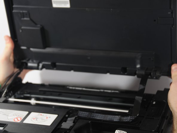

  4. Brother MFC-490CW Print head Replacement, Remove the scanner unit from the device: crwdns2935265:04crwdnd2935265:01crwdnd2935265:03crwdne2935265:0 Brother MFC-490CW Print head Replacement, Remove the scanner unit from the device: crwdns2935265:04crwdnd2935265:02crwdnd2935265:03crwdne2935265:0 Brother MFC-490CW Print head Replacement, Remove the scanner unit from the device: crwdns2935265:04crwdnd2935265:03crwdnd2935265:03crwdne2935265:0
    • Slide the unit either to the left or right and begin to push the unit away from the device.
    • Once one hinge is separated from the device, begin to remove the other hinge from the device.
    • Gently place the unit on the work surface.
    • Be careful not to pull too hard. the wires connecting the unit to the device must be removed.

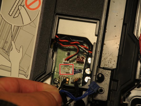

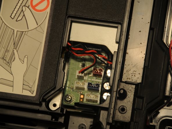

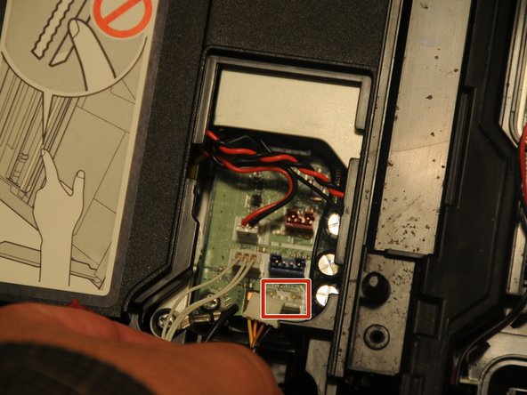

  7. Brother MFC-490CW Print head Replacement, Removing left set of power cables: crwdns2935265:07crwdnd2935265:01crwdnd2935265:03crwdne2935265:0 Brother MFC-490CW Print head Replacement, Removing left set of power cables: crwdns2935265:07crwdnd2935265:02crwdnd2935265:03crwdne2935265:0 Brother MFC-490CW Print head Replacement, Removing left set of power cables: crwdns2935265:07crwdnd2935265:03crwdnd2935265:03crwdne2935265:0
    • Before removing the cables, create a diagram of the locations of the different cables with some tape or Post-Its.
    • Remove the three power cables that connect the scanner to the motherboard.

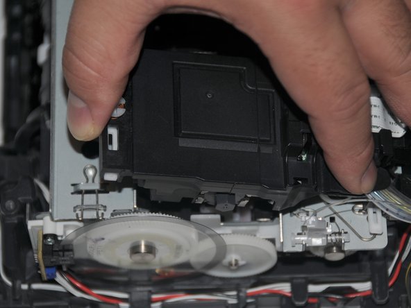

  18. Brother MFC-490CW Print head Replacement, Releasing the print head from the carriage: crwdns2935265:018crwdnd2935265:01crwdnd2935265:02crwdne2935265:0 Brother MFC-490CW Print head Replacement, Releasing the print head from the carriage: crwdns2935265:018crwdnd2935265:02crwdnd2935265:02crwdne2935265:0
    • Using a spudger, press down on the plastic housing of the carriage that the print head rests on.
    • Slide the print head to the left of the device.
  19. Brother MFC-490CW Print head Replacement, Removing the print head from the rails.: crwdns2935265:019crwdnd2935265:01crwdnd2935265:03crwdne2935265:0 Brother MFC-490CW Print head Replacement, Removing the print head from the rails.: crwdns2935265:019crwdnd2935265:02crwdnd2935265:03crwdne2935265:0 Brother MFC-490CW Print head Replacement, Removing the print head from the rails.: crwdns2935265:019crwdnd2935265:03crwdnd2935265:03crwdne2935265:0
    • Slide the print head until it is at the end of the rail.
    • Push the print head unit towards the back of the device and lift the unit from the back rail.
    • Gently release the other end of the print head to remove it from the front rail.

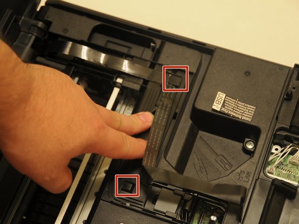

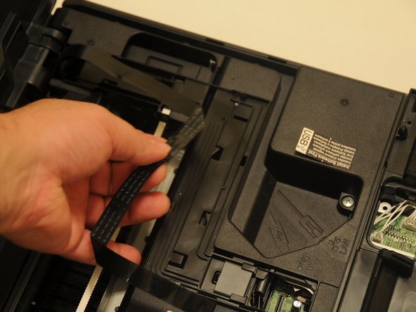

  22. Brother MFC-490CW Print head Replacement, Remove the data cable from the print head processing unit.: crwdns2935265:022crwdnd2935265:01crwdnd2935265:02crwdne2935265:0 Brother MFC-490CW Print head Replacement, Remove the data cable from the print head processing unit.: crwdns2935265:022crwdnd2935265:02crwdnd2935265:02crwdne2935265:0
    • Slide the black cap away from the port.
    • Slide the data cable out of the port.

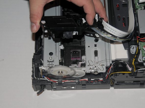

  23. Brother MFC-490CW Print head Replacement, Remove print head processor unit: crwdns2935265:023crwdnd2935265:01crwdnd2935265:03crwdne2935265:0 Brother MFC-490CW Print head Replacement, Remove print head processor unit: crwdns2935265:023crwdnd2935265:02crwdnd2935265:03crwdne2935265:0 Brother MFC-490CW Print head Replacement, Remove print head processor unit: crwdns2935265:023crwdnd2935265:03crwdnd2935265:03crwdne2935265:0
    • Lift the processor out of the print head.
    • Slide the cables attached to the processor away from the print head unit.
  24. Brother MFC-490CW Print head Replacement, Remove the inkjet nozzle unit.: crwdns2935265:024crwdnd2935265:01crwdnd2935265:03crwdne2935265:0 Brother MFC-490CW Print head Replacement, Remove the inkjet nozzle unit.: crwdns2935265:024crwdnd2935265:02crwdnd2935265:03crwdne2935265:0 Brother MFC-490CW Print head Replacement, Remove the inkjet nozzle unit.: crwdns2935265:024crwdnd2935265:03crwdnd2935265:03crwdne2935265:0
    • Remove the metal clip holding the nozzle unit.
    • Lift the unit from the rest of the print head unit.
