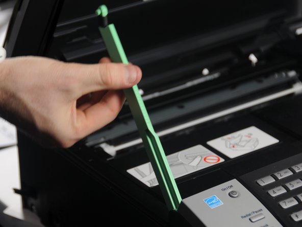

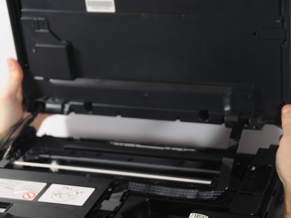

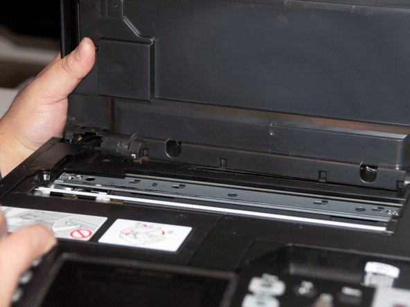

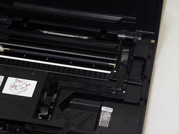

  3. Brother MFC-490CW Motherboard Replacement, Motherboard: crwdns2935265:03crwdnd2935265:01crwdnd2935265:03crwdne2935265:0 Brother MFC-490CW Motherboard Replacement, Motherboard: crwdns2935265:03crwdnd2935265:02crwdnd2935265:03crwdne2935265:0 Brother MFC-490CW Motherboard Replacement, Motherboard: crwdns2935265:03crwdnd2935265:03crwdnd2935265:03crwdne2935265:0
    • Lift the scanner unit lid.
    • Gently twist the top portion of the arm. The top portion should release from the scanner unit.
    • Rotate the arm approximately 45 degrees to remove the bottom portion from the device.
    • Before removing the unit, apply 2-3 pieces of tape to secure the top and bottom of the unit.

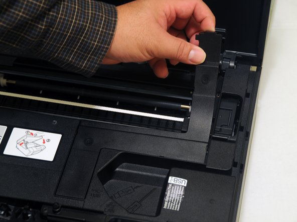

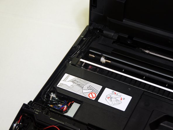

  4. Brother MFC-490CW Motherboard Replacement: crwdns2935265:04crwdnd2935265:01crwdnd2935265:03crwdne2935265:0 Brother MFC-490CW Motherboard Replacement: crwdns2935265:04crwdnd2935265:02crwdnd2935265:03crwdne2935265:0 Brother MFC-490CW Motherboard Replacement: crwdns2935265:04crwdnd2935265:03crwdnd2935265:03crwdne2935265:0
    • Slide the unit either to the left or right and push it away from the device.
    • Once one hinge is separated from the device, begin to remove the other hinge.
    • Gently place the unit on the work surface.
    • Be careful not to pull too hard. The wires connecting the unit to the device must be removed.

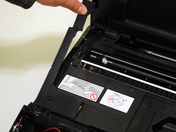

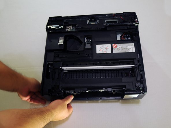

  5. Brother MFC-490CW Motherboard Replacement: crwdns2935265:05crwdnd2935265:01crwdnd2935265:03crwdne2935265:0 Brother MFC-490CW Motherboard Replacement: crwdns2935265:05crwdnd2935265:02crwdnd2935265:03crwdne2935265:0 Brother MFC-490CW Motherboard Replacement: crwdns2935265:05crwdnd2935265:03crwdnd2935265:03crwdne2935265:0
    • From the back of the device, use the exposed portion of the panel and gently begin to remove the panel away from the device.
    • While it is not necessary to use a prying tool, a thin prying tool can help lift the panels.

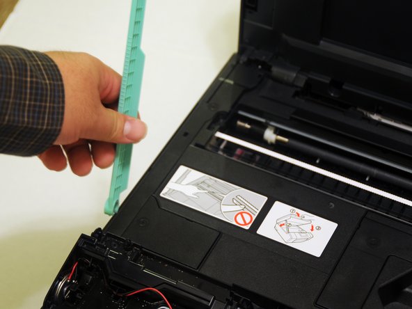

  6. Brother MFC-490CW Motherboard Replacement: crwdns2935265:06crwdnd2935265:01crwdnd2935265:03crwdne2935265:0 Brother MFC-490CW Motherboard Replacement: crwdns2935265:06crwdnd2935265:02crwdnd2935265:03crwdne2935265:0 Brother MFC-490CW Motherboard Replacement: crwdns2935265:06crwdnd2935265:03crwdnd2935265:03crwdne2935265:0
    • Use the exposed portion of the panel to begin to lift the panel away from the back of the device.

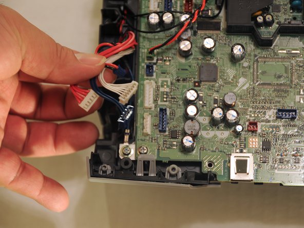

  7. Brother MFC-490CW Motherboard Replacement: crwdns2935265:07crwdnd2935265:01crwdnd2935265:03crwdne2935265:0 Brother MFC-490CW Motherboard Replacement: crwdns2935265:07crwdnd2935265:02crwdnd2935265:03crwdne2935265:0 Brother MFC-490CW Motherboard Replacement: crwdns2935265:07crwdnd2935265:03crwdnd2935265:03crwdne2935265:0

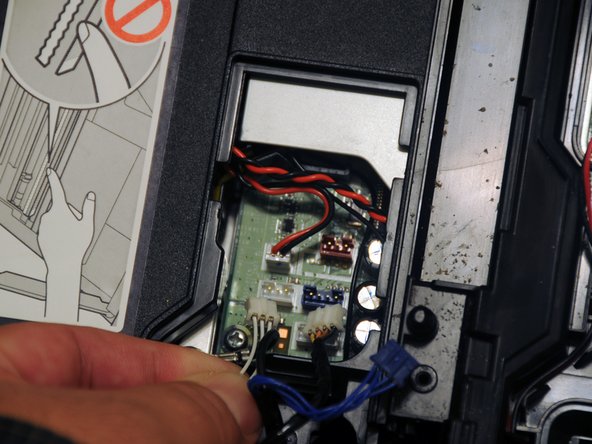

    • Remove the three power cables that connect the scanner to the motherboard on the left side.
    • Before removing the cables, create a diagram of their locations. Label the cables with some tape or post-its.

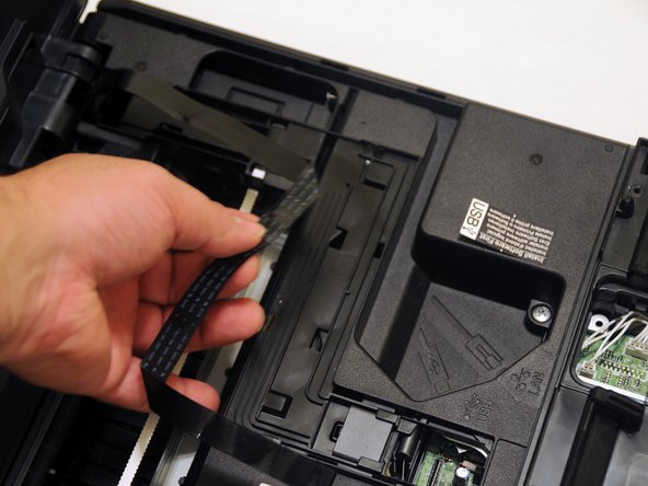

    • Gently pull the data cable out of the motherboard.
    • Slide the cable out of the slots to remove it from the device.

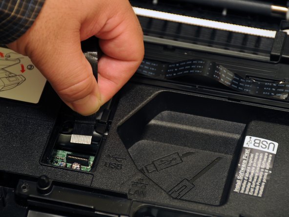

  10. Brother MFC-490CW Motherboard Replacement: crwdns2935265:010crwdnd2935265:01crwdnd2935265:01crwdne2935265:0
    • Unscrew the three 14.1mm screws.
    • Unscrew the 12.1mm screw.

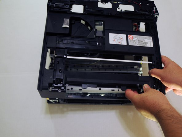

  11. Brother MFC-490CW Motherboard Replacement: crwdns2935265:011crwdnd2935265:01crwdnd2935265:01crwdne2935265:0
    • Pull the paper tray away from the device.

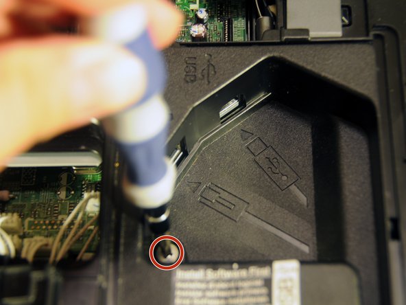

    • Locate and remove the screw near the USB and ethernet ports.
    • Unscrew the 8mm screw at the center of the device.

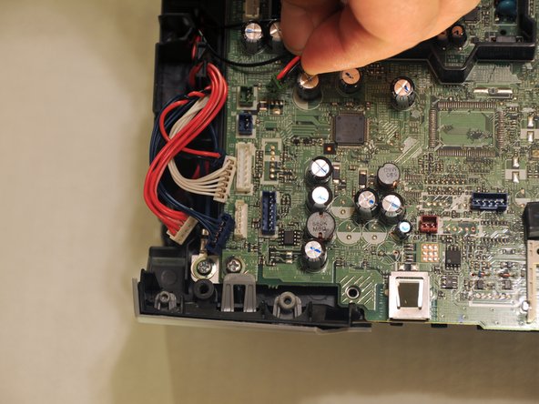

  14. Brother MFC-490CW Motherboard Replacement: crwdns2935265:014crwdnd2935265:01crwdnd2935265:02crwdne2935265:0 Brother MFC-490CW Motherboard Replacement: crwdns2935265:014crwdnd2935265:02crwdnd2935265:02crwdne2935265:0

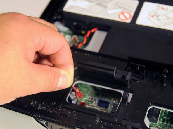

    • Gently remove the red power cable from the motherboard.
    • This cable needs to be taken out to allow the removal of the device cover.

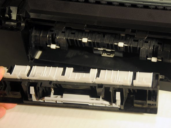

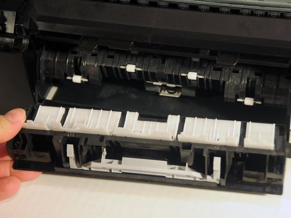

  15. Brother MFC-490CW Motherboard Replacement: crwdns2935265:015crwdnd2935265:01crwdnd2935265:03crwdne2935265:0 Brother MFC-490CW Motherboard Replacement: crwdns2935265:015crwdnd2935265:02crwdnd2935265:03crwdne2935265:0 Brother MFC-490CW Motherboard Replacement: crwdns2935265:015crwdnd2935265:03crwdnd2935265:03crwdne2935265:0
    • Gently push the upper-left tab of the paper jam clear cover and separate the hinged portion of the cover from the rest of the device.
    • Once one side of free, slide the other side away from the device.
    • Pull the cover away from the device.
  16. Brother MFC-490CW Motherboard Replacement: crwdns2935265:016crwdnd2935265:01crwdnd2935265:03crwdne2935265:0 Brother MFC-490CW Motherboard Replacement: crwdns2935265:016crwdnd2935265:02crwdnd2935265:03crwdne2935265:0 Brother MFC-490CW Motherboard Replacement: crwdns2935265:016crwdnd2935265:03crwdnd2935265:03crwdne2935265:0
    • Using a spudger, loosen the two clipped portions of the cover located at the back-center of the device.
    • Once the clips are free the rest of the cover can be lifted up and away from the device.
  17. Brother MFC-490CW Motherboard Replacement: crwdns2935265:017crwdnd2935265:01crwdnd2935265:03crwdne2935265:0 Brother MFC-490CW Motherboard Replacement: crwdns2935265:017crwdnd2935265:02crwdnd2935265:03crwdne2935265:0 Brother MFC-490CW Motherboard Replacement: crwdns2935265:017crwdnd2935265:03crwdnd2935265:03crwdne2935265:0
    • Push the left and right clipped portion of the front port cover away from the device.

  19. Brother MFC-490CW Motherboard Replacement: crwdns2935265:019crwdnd2935265:01crwdnd2935265:03crwdne2935265:0 Brother MFC-490CW Motherboard Replacement: crwdns2935265:019crwdnd2935265:02crwdnd2935265:03crwdne2935265:0 Brother MFC-490CW Motherboard Replacement: crwdns2935265:019crwdnd2935265:03crwdnd2935265:03crwdne2935265:0

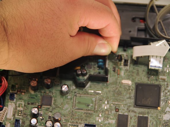

    • Gently pull the five power cables on the left side, away from the motherboard.
    • Label the cables with post-its or tape before removal.
  20. Brother MFC-490CW Motherboard Replacement: crwdns2935265:020crwdnd2935265:01crwdnd2935265:02crwdne2935265:0 Brother MFC-490CW Motherboard Replacement: crwdns2935265:020crwdnd2935265:02crwdnd2935265:02crwdne2935265:0
    • Gently lift the five power cables on the right side away from the motherboard.
    • Label the cables with posti-its or tape before removing them from the motherboard.

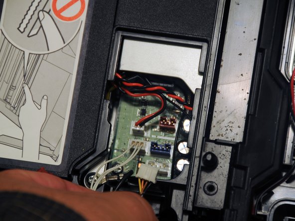

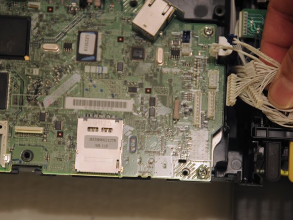

  21. Brother MFC-490CW Motherboard Replacement: crwdns2935265:021crwdnd2935265:01crwdnd2935265:02crwdne2935265:0 Brother MFC-490CW Motherboard Replacement: crwdns2935265:021crwdnd2935265:02crwdnd2935265:02crwdne2935265:0
    • Lable the white cable before removal.
    • Add a label to the port where the white power cable is inserted.
    • Remove the rear black and white power cables.

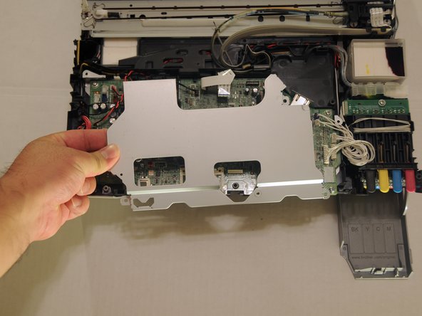

  22. Brother MFC-490CW Motherboard Replacement: crwdns2935265:022crwdnd2935265:01crwdnd2935265:03crwdne2935265:0 Brother MFC-490CW Motherboard Replacement: crwdns2935265:022crwdnd2935265:02crwdnd2935265:03crwdne2935265:0 Brother MFC-490CW Motherboard Replacement: crwdns2935265:022crwdnd2935265:03crwdnd2935265:03crwdne2935265:0

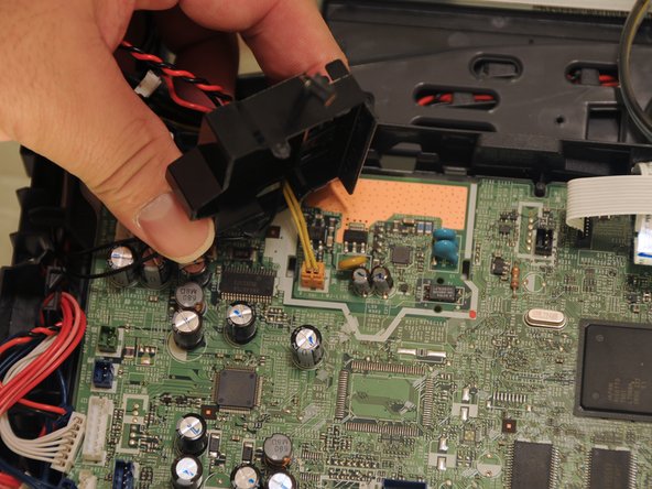

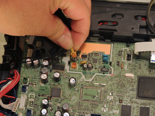

    • Squeeze the clips of the cover protecting the orange power cable.
    • Lift the cover away from the motherboard and set it aside.
    • Gently lift the orange power cable away from the motherboard.
  23. Brother MFC-490CW Motherboard Replacement: crwdns2935265:023crwdnd2935265:01crwdnd2935265:03crwdne2935265:0 Brother MFC-490CW Motherboard Replacement: crwdns2935265:023crwdnd2935265:02crwdnd2935265:03crwdne2935265:0 Brother MFC-490CW Motherboard Replacement: crwdns2935265:023crwdnd2935265:03crwdnd2935265:03crwdne2935265:0

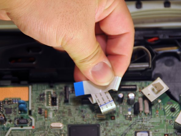

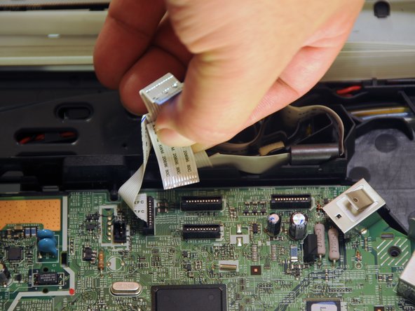

    • Gently, lift the data cables away from the motherboard.
    • To avoid any confusion, create a diagram of the location of the data cables and label the them.
  24. Brother MFC-490CW Motherboard Replacement: crwdns2935265:024crwdnd2935265:01crwdnd2935265:03crwdne2935265:0 Brother MFC-490CW Motherboard Replacement: crwdns2935265:024crwdnd2935265:02crwdnd2935265:03crwdne2935265:0 Brother MFC-490CW Motherboard Replacement: crwdns2935265:024crwdnd2935265:03crwdnd2935265:03crwdne2935265:0
    • Using a screwdriver, remove the four 12.1 mm screws.
    • Lift the motherboard away from the rest of the device.
