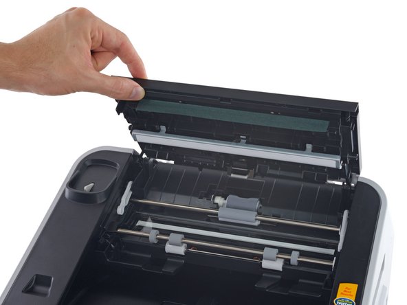

      • Remove the two 15 mm Phillips #1 screws securing the ADF at the rear of the fax machine.
    2. Brother IntelliFax-2840 Control Panel Replacement: crwdns2935265:02crwdnd2935265:01crwdnd2935265:02crwdne2935265:0 Brother IntelliFax-2840 Control Panel Replacement: crwdns2935265:02crwdnd2935265:02crwdnd2935265:02crwdne2935265:0
      • Gently pull the ADF up and away from the machine.

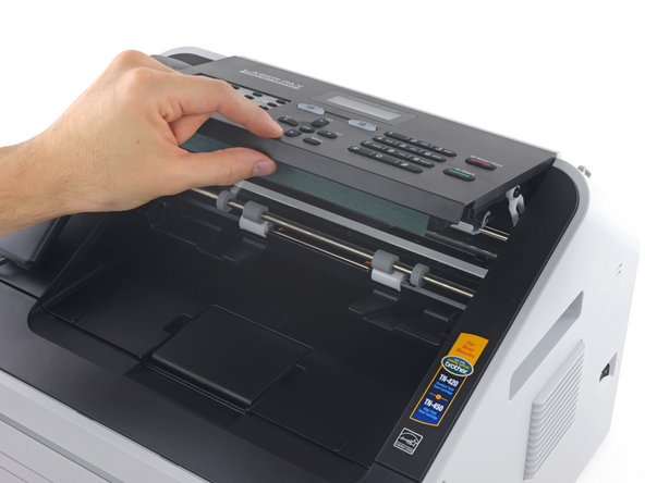

    1. Brother IntelliFax-2840 Control Panel Replacement, Control Panel: crwdns2935265:03crwdnd2935265:01crwdnd2935265:02crwdne2935265:0 Brother IntelliFax-2840 Control Panel Replacement, Control Panel: crwdns2935265:03crwdnd2935265:02crwdnd2935265:02crwdne2935265:0
      • Gently lift up the control panel.

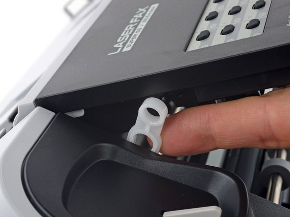

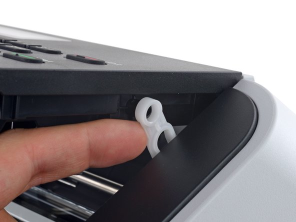

    2. Brother IntelliFax-2840 Control Panel Replacement: crwdns2935265:04crwdnd2935265:01crwdnd2935265:03crwdne2935265:0 Brother IntelliFax-2840 Control Panel Replacement: crwdns2935265:04crwdnd2935265:02crwdnd2935265:03crwdne2935265:0 Brother IntelliFax-2840 Control Panel Replacement: crwdns2935265:04crwdnd2935265:03crwdnd2935265:03crwdne2935265:0
      • Use a finger or prying tool to gently pop off the right side control arm (furthest from the handset).
      • Repeat for the left side control arm.
      • You can make this task easier by taking the handset out of the cradle and setting it aside.
    3. Brother IntelliFax-2840 Control Panel Replacement: crwdns2935265:05crwdnd2935265:01crwdnd2935265:02crwdne2935265:0 Brother IntelliFax-2840 Control Panel Replacement: crwdns2935265:05crwdnd2935265:02crwdnd2935265:02crwdne2935265:0
      • Do not attempt to completely remove the control panel yet, as it is still connected by a cable.
      • Lifting from the front edge, gently flip up the control panel.

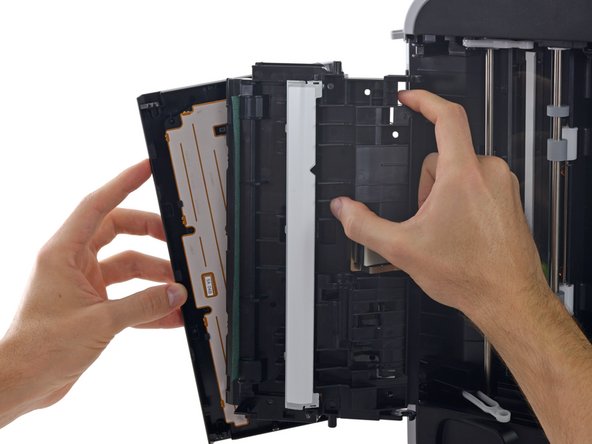

    5. Brother IntelliFax-2840 Control Panel Replacement: crwdns2935265:07crwdnd2935265:01crwdnd2935265:01crwdne2935265:0
      • While still supporting the control panel, use your fingers or a spudger to gently free the two plastic clips securing the rear control panel cover.
      • Slide the rear control panel cover down slightly to free it from the three clips along the upper edge.
    6. Brother IntelliFax-2840 Control Panel Replacement: crwdns2935265:08crwdnd2935265:01crwdnd2935265:02crwdne2935265:0 Brother IntelliFax-2840 Control Panel Replacement: crwdns2935265:08crwdnd2935265:02crwdnd2935265:02crwdne2935265:0
      • Separate the rear control panel cover from the control panel.

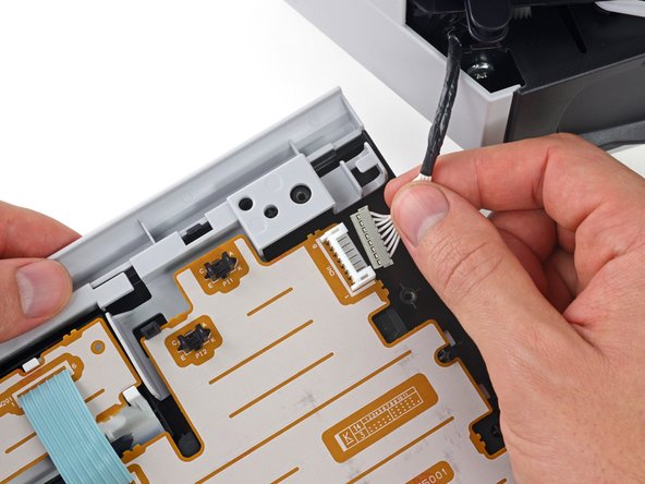

    7. Brother IntelliFax-2840 Control Panel Replacement: crwdns2935265:09crwdnd2935265:01crwdnd2935265:02crwdne2935265:0 Brother IntelliFax-2840 Control Panel Replacement: crwdns2935265:09crwdnd2935265:02crwdnd2935265:02crwdne2935265:0
      • Gently pull the control panel cable straight out from its connector.
      • The control panel should now come free.
