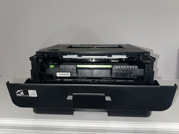

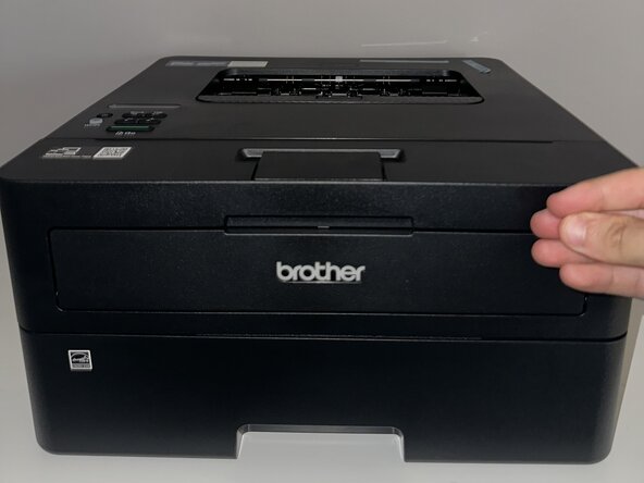

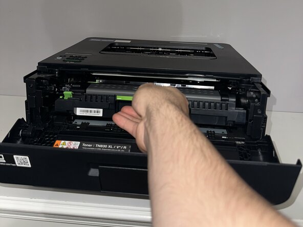

    • Open the front cover of the printer.
    • Turn off the printer and let it cool down for 10 minutes.
  2. Brother HL-L2400D Drum Replacement: crwdns2935265:02crwdnd2935265:01crwdnd2935265:02crwdne2935265:0 Brother HL-L2400D Drum Replacement: crwdns2935265:02crwdnd2935265:02crwdnd2935265:02crwdne2935265:0
    • Grab the green tab and pull the part out.

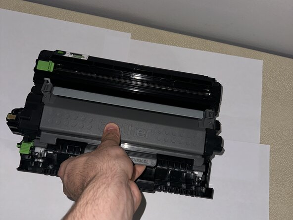

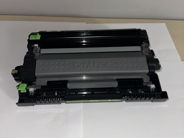

    • Place the drum onto a sheet of paper.

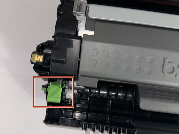

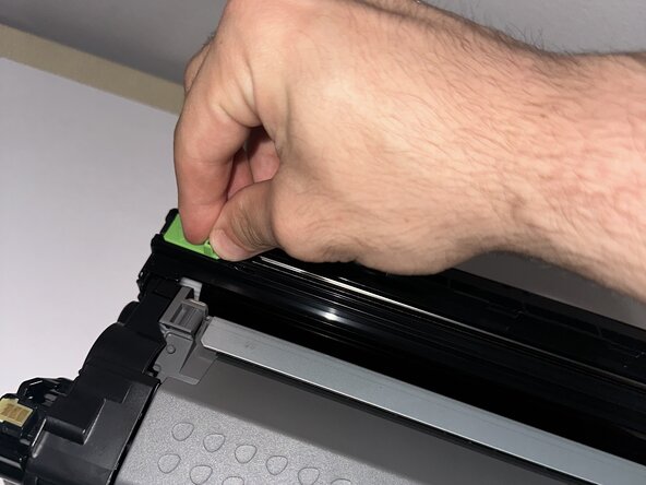

    • Press the green tab on the side to pop out the inside component.
  4. Brother HL-L2400D Drum Replacement: crwdns2935265:04crwdnd2935265:01crwdnd2935265:02crwdne2935265:0 Brother HL-L2400D Drum Replacement: crwdns2935265:04crwdnd2935265:02crwdnd2935265:02crwdne2935265:0

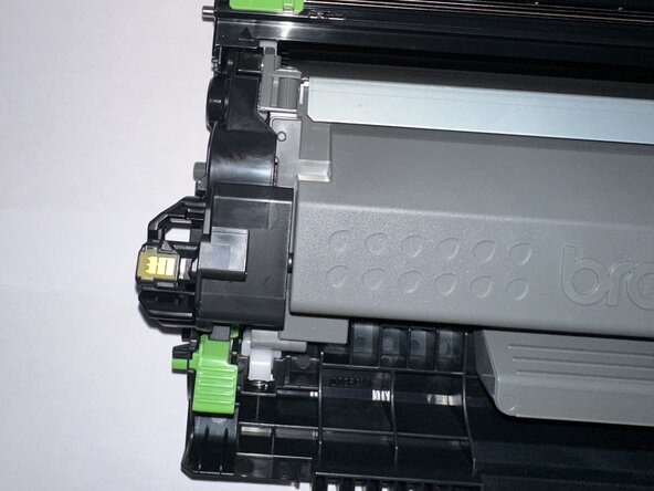

    • Press the green tab firmly until you hear a noise.
    • Pull out the drum using the closest grey part to you.

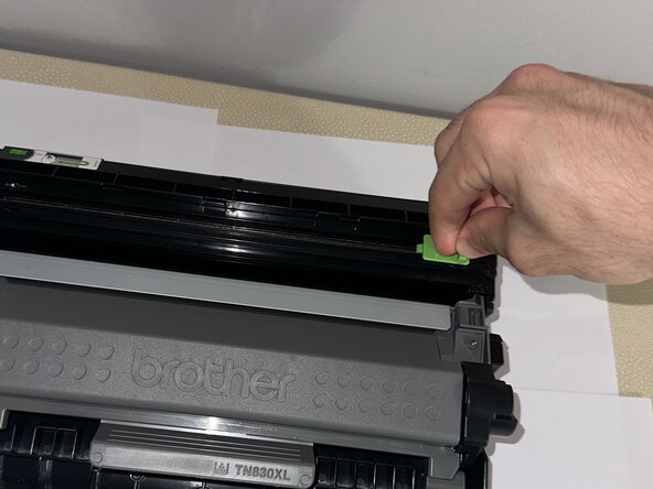

    • To clean the imaging of the drum, use the slider above.
    • Make sure to go back and forth with the slider several times.
