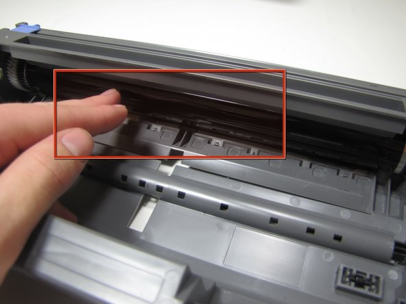

  3. Brother HL-5240 Toner Cartridge Replacement, Toner Cartridge: crwdns2935265:03crwdnd2935265:01crwdnd2935265:03crwdne2935265:0 Brother HL-5240 Toner Cartridge Replacement, Toner Cartridge: crwdns2935265:03crwdnd2935265:02crwdnd2935265:03crwdne2935265:0 Brother HL-5240 Toner Cartridge Replacement, Toner Cartridge: crwdns2935265:03crwdnd2935265:03crwdnd2935265:03crwdne2935265:0
    • The drum unit is the gray bottom half of the component in the picture, while the top black part is the toner cartridge.
    • Separate the toner cartridge from the drum unit by pressing down on the blue tab and gently lifting the toner cartridge up by the lift on the handle.
    • DO NOT TOUCH the roller bar on the toner cartridge, or the roller bar on the drum unit as illustrated in the pictures. This may cause a decrease in print quality.

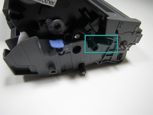

  4. Brother HL-5240 Toner Cartridge Replacement: crwdns2935265:04crwdnd2935265:01crwdnd2935265:03crwdne2935265:0 Brother HL-5240 Toner Cartridge Replacement: crwdns2935265:04crwdnd2935265:02crwdnd2935265:03crwdne2935265:0 Brother HL-5240 Toner Cartridge Replacement: crwdns2935265:04crwdnd2935265:03crwdnd2935265:03crwdne2935265:0
    • Insert the toner cartridge into the new drum break by firmly sliding the cartridge into the drum unit. If installed correctly, the blue lever will be locked in a lifted position.
    • Be sure that the black nob located on the back of the toner cartridge is places inside the track located on the drum unit.
    • The third picture illustrates an incorrectly installed drum unit and toner cartridge, notice how the blue lever is down.
