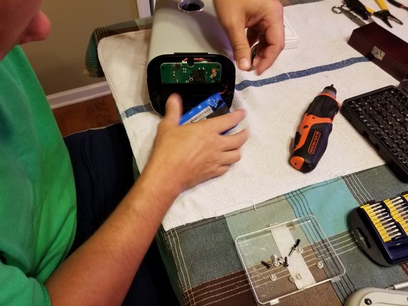

  5. Brookstone Big Blue Party/360 Speaker Battery Replacement, Remove old battery: crwdns2935265:05crwdnd2935265:01crwdnd2935265:03crwdne2935265:0 Brookstone Big Blue Party/360 Speaker Battery Replacement, Remove old battery: crwdns2935265:05crwdnd2935265:02crwdnd2935265:03crwdne2935265:0 Brookstone Big Blue Party/360 Speaker Battery Replacement, Remove old battery: crwdns2935265:05crwdnd2935265:03crwdnd2935265:03crwdne2935265:0
    • Pull off the tape
    • Remove the battery
    • Use small pliers to unplug battery connector from the circuit board.
    • Carefully guide the wire out from under the circuit board.

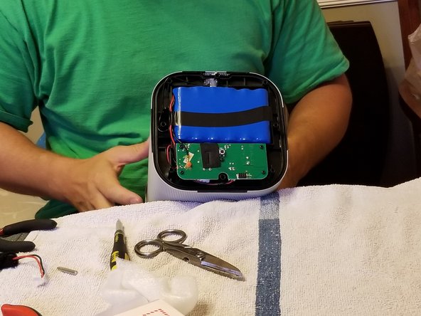

  7. Brookstone Big Blue Party/360 Speaker Battery Replacement, Install new battery: crwdns2935265:07crwdnd2935265:01crwdnd2935265:03crwdne2935265:0 Brookstone Big Blue Party/360 Speaker Battery Replacement, Install new battery: crwdns2935265:07crwdnd2935265:02crwdnd2935265:03crwdne2935265:0 Brookstone Big Blue Party/360 Speaker Battery Replacement, Install new battery: crwdns2935265:07crwdnd2935265:03crwdnd2935265:03crwdne2935265:0
    • Insert new battery into compartment
    • Use electrical tape to hold it down
    • Guide the wire under the circuit board to the connector
    • Connect new battery to the circuit board.
