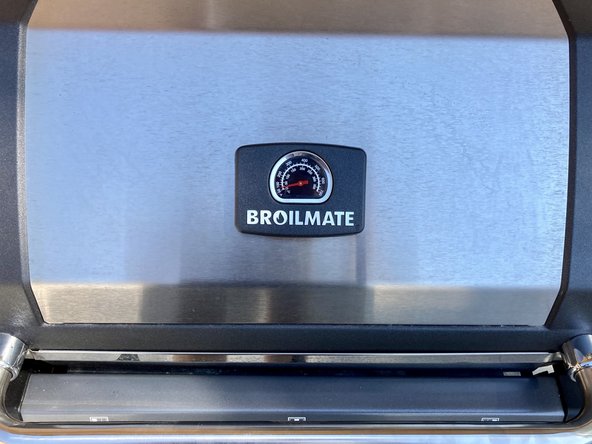

    • Gather the tools and parts needed for the repair:
    • Crescent Wrench
    • Scraper
    • Replacement Heat Indicator
    • Be sure that the grill is completely cool and disconnect any gas tanks before beginning the repair.

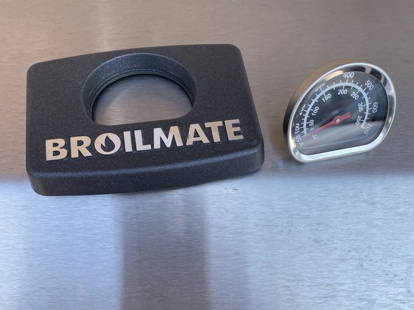

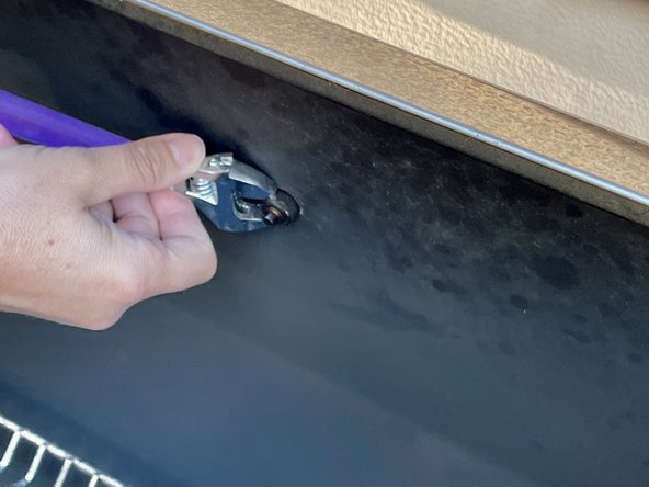

  2. Broil-King BBQ Heat Indicator Replacement Guide: crwdns2935265:02crwdnd2935265:01crwdnd2935265:02crwdne2935265:0 Broil-King BBQ Heat Indicator Replacement Guide: crwdns2935265:02crwdnd2935265:02crwdnd2935265:02crwdne2935265:0
    • Open the lid and then remove the nut securing the heat indicator.
    • Use a crescent wrench to loosen the nut.
    • Continue to unthread the nut with your fingers.
    • Place the nut in a secure location for later use.

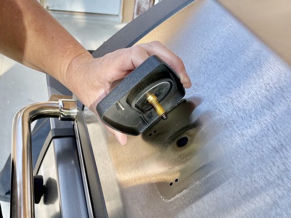

  3. Broil-King BBQ Heat Indicator Replacement Guide: crwdns2935265:03crwdnd2935265:01crwdnd2935265:02crwdne2935265:0 Broil-King BBQ Heat Indicator Replacement Guide: crwdns2935265:03crwdnd2935265:02crwdnd2935265:02crwdne2935265:0
    • Close the lid.
    • Slide the flat edge of the paint scraper under the existing heat indicator plate to pry the plate loose.
    • Lift the plate up, then off of the predrilled holes.

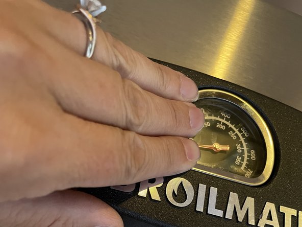

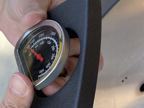

  4. Broil-King BBQ Heat Indicator Replacement Guide: crwdns2935265:04crwdnd2935265:01crwdnd2935265:03crwdne2935265:0 Broil-King BBQ Heat Indicator Replacement Guide: crwdns2935265:04crwdnd2935265:02crwdnd2935265:03crwdne2935265:0 Broil-King BBQ Heat Indicator Replacement Guide: crwdns2935265:04crwdnd2935265:03crwdnd2935265:03crwdne2935265:0
    • Push the heat indicator from the back to remove it from the Broilmate plate.

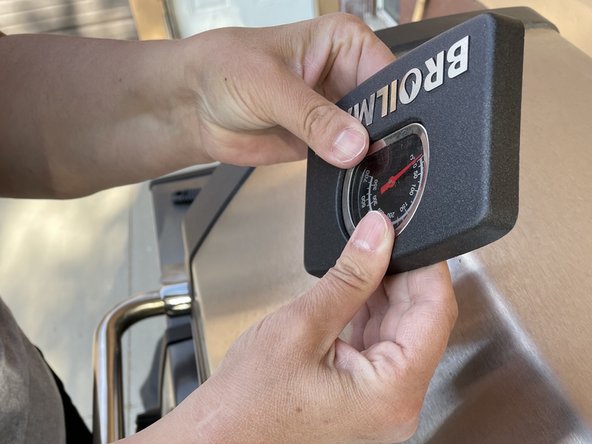

  5. Broil-King BBQ Heat Indicator Replacement Guide: crwdns2935265:05crwdnd2935265:01crwdnd2935265:03crwdne2935265:0 Broil-King BBQ Heat Indicator Replacement Guide: crwdns2935265:05crwdnd2935265:02crwdnd2935265:03crwdne2935265:0 Broil-King BBQ Heat Indicator Replacement Guide: crwdns2935265:05crwdnd2935265:03crwdnd2935265:03crwdne2935265:0
    • Align the new heat indicator through the front of the plate.
    • Move your thumbs around the plate until the heat indicator is secure.

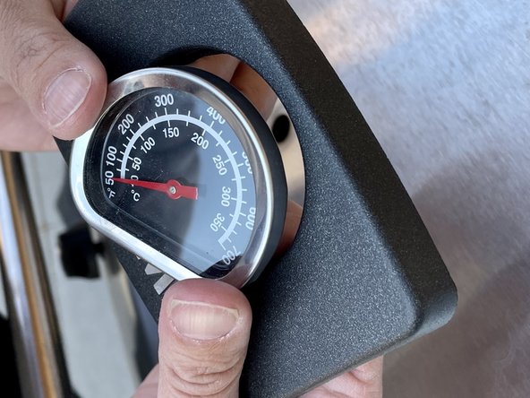

  6. Broil-King BBQ Heat Indicator Replacement Guide: crwdns2935265:06crwdnd2935265:01crwdnd2935265:03crwdne2935265:0 Broil-King BBQ Heat Indicator Replacement Guide: crwdns2935265:06crwdnd2935265:02crwdnd2935265:03crwdne2935265:0 Broil-King BBQ Heat Indicator Replacement Guide: crwdns2935265:06crwdnd2935265:03crwdnd2935265:03crwdne2935265:0
    • Align the new heat indicator and plate with the factory drilled holes on the face of the BBQ.
    • Hold the plate in place while opening the lid.
