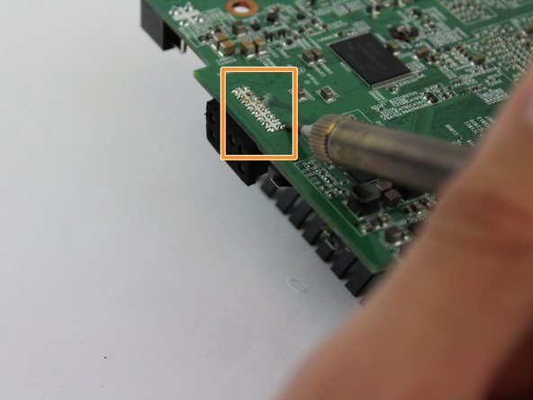

  7. Brightsign 4k LED Display Replacement, LED Display: crwdns2935265:07crwdnd2935265:01crwdnd2935265:02crwdne2935265:0 Brightsign 4k LED Display Replacement, LED Display: crwdns2935265:07crwdnd2935265:02crwdnd2935265:02crwdne2935265:0
    • Turn the motherboard over and locate the solders holding the LED Display in place.
    • Use the soldering iron to desolder the sixteen solder joints and remove the melted solder with the pump shown in Step 8.
    • The soldering iron can become extremely hot, handle with caution.

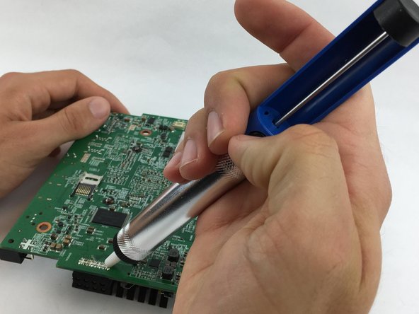

  8. Brightsign 4k LED Display Replacement: crwdns2935265:08crwdnd2935265:01crwdnd2935265:03crwdne2935265:0 Brightsign 4k LED Display Replacement: crwdns2935265:08crwdnd2935265:02crwdnd2935265:03crwdne2935265:0 Brightsign 4k LED Display Replacement: crwdns2935265:08crwdnd2935265:03crwdnd2935265:03crwdne2935265:0
    Desoldering Pump
    $3.99
    • Apply the desoldering pump to remove the melted part from the motherboard (press the button to release it).

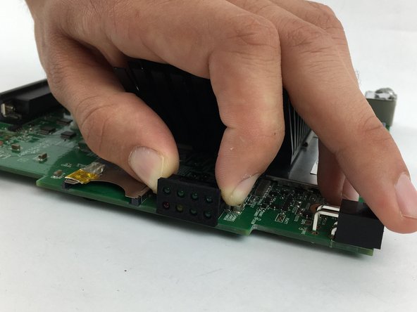

    • After the solders have been removed, gently pull the LED Display from the motherboard.
