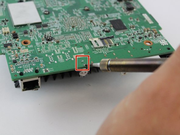

    • Flip the motherboard over.
    • Desolder the two solder joints and remove the melted solder.
    • Beware of over heating the soldering kit will damage the logic board.

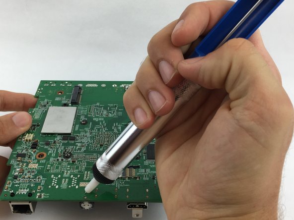

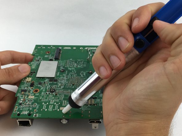

  8. Brightsign 4k Battery Replacement: crwdns2935265:08crwdnd2935265:01crwdnd2935265:03crwdne2935265:0 Brightsign 4k Battery Replacement: crwdns2935265:08crwdnd2935265:02crwdnd2935265:03crwdne2935265:0 Brightsign 4k Battery Replacement: crwdns2935265:08crwdnd2935265:03crwdnd2935265:03crwdne2935265:0
    Desoldering Pump
    $3.99
    • Apply the desoldering pump to remove the melted part from the motherboard (press the button to release it).
    • Pull the battery from the motherboard.
