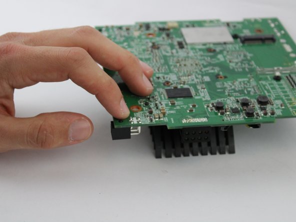

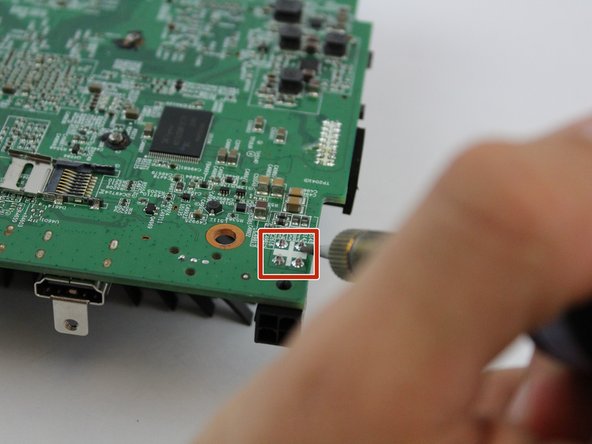

  7. BrightSign 4K Battery Charging Port Replacement, Battery Charging Port: crwdns2935265:07crwdnd2935265:01crwdnd2935265:03crwdne2935265:0 BrightSign 4K Battery Charging Port Replacement, Battery Charging Port: crwdns2935265:07crwdnd2935265:02crwdnd2935265:03crwdne2935265:0 BrightSign 4K Battery Charging Port Replacement, Battery Charging Port: crwdns2935265:07crwdnd2935265:03crwdnd2935265:03crwdne2935265:0
    • Flip the motherboard over so the heatsink is facing down.
    • Desolder the four solder joints and remove the melted solder with the pump.

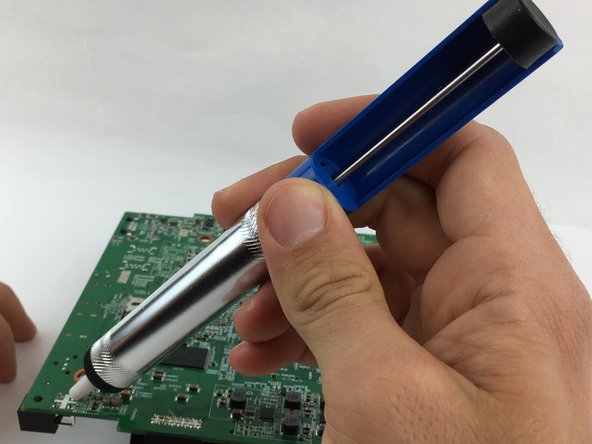

  8. BrightSign 4K Battery Charging Port Replacement: crwdns2935265:08crwdnd2935265:01crwdnd2935265:03crwdne2935265:0 BrightSign 4K Battery Charging Port Replacement: crwdns2935265:08crwdnd2935265:02crwdnd2935265:03crwdne2935265:0 BrightSign 4K Battery Charging Port Replacement: crwdns2935265:08crwdnd2935265:03crwdnd2935265:03crwdne2935265:0
    Desoldering Pump
    $3.99

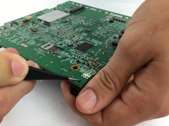

    • Apply the desoldering pump to remove the melted part from the motherboard (press the button to release it).
    • Using the tweezers apply pressure to the spade head clip shown.
    • Remove the charging port by pulling the piece off.
