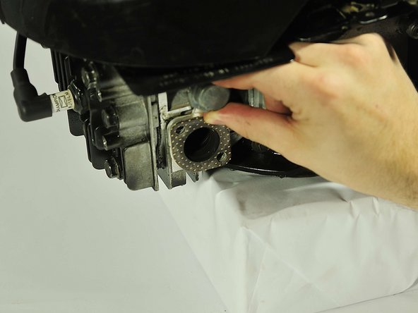

  4. Briggs and Stratton 675 Series Repair Muffler Replacement: crwdns2935265:04crwdnd2935265:01crwdnd2935265:02crwdne2935265:0 Briggs and Stratton 675 Series Repair Muffler Replacement: crwdns2935265:04crwdnd2935265:02crwdnd2935265:02crwdne2935265:0
    • Remove the muffler from the engine block by simply pulling it away.
    • After removing the muffler, make sure to note the configuration of the washer assembly that sits between the muffler and the engine block (shown in photo 2). This piece will be free to fall out once the muffler is removed. Do not lose this piece.

When I removed the muffler from the engine block by simply pulling it away, the thermic regulator fell out and I don't see how/where to fix it again.
Thanks for any help !!!
yvessr - crwdns2934203:0crwdne2934203:0
Obtain the parts diagram for your model. Use the drawing as a guide for re-installation.
