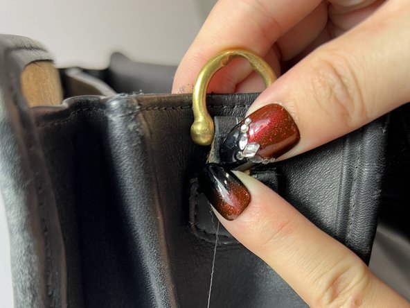

Briefcase Strap Holder Replacement
  1. Briefcase Strap Holder Replacement, Strap Holder: crwdns2935265:01crwdnd2935265:01crwdnd2935265:01crwdne2935265:0

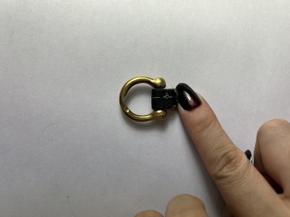

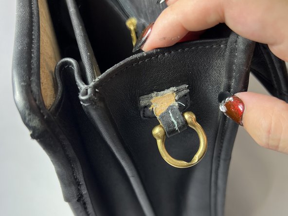

    • Cut the whole old strap holder from the bag.
    • If the strap holder breaks in other parts, cut it all out.
  2. Briefcase Strap Holder Replacement: crwdns2935265:02crwdnd2935265:01crwdnd2935265:02crwdne2935265:0 Briefcase Strap Holder Replacement: crwdns2935265:02crwdnd2935265:02crwdnd2935265:02crwdne2935265:0

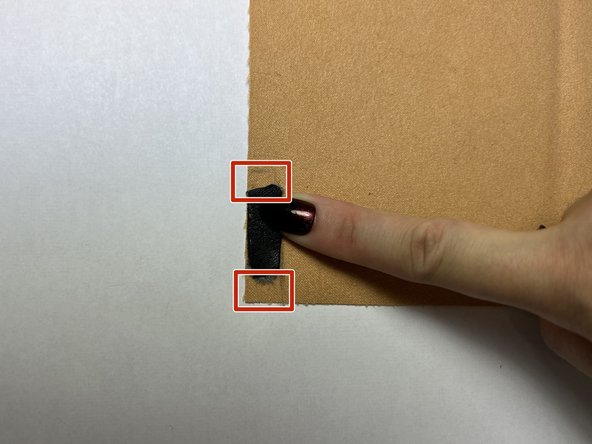

    • Draw a longer shape of the strap holder with a pencil on another piece of fabric.
    • Both extensions should be the same length, at least 1/4 to 1/2inch long.
  3. Briefcase Strap Holder Replacement: crwdns2935265:03crwdnd2935265:01crwdnd2935265:01crwdne2935265:0
    • Cut the piece of fabric.
  4. Briefcase Strap Holder Replacement: crwdns2935265:04crwdnd2935265:01crwdnd2935265:02crwdne2935265:0 Briefcase Strap Holder Replacement: crwdns2935265:04crwdnd2935265:02crwdnd2935265:02crwdne2935265:0

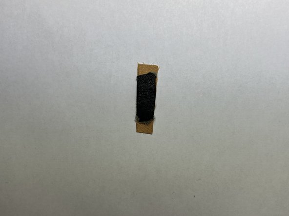

    • Add glue in the center of the new piece of fabric.
    • Glue the strap holder on in the center and leave the same length on both sides.
    • You can also use a glue gun.
  5. Briefcase Strap Holder Replacement: crwdns2935265:05crwdnd2935265:01crwdnd2935265:02crwdne2935265:0 Briefcase Strap Holder Replacement: crwdns2935265:05crwdnd2935265:02crwdnd2935265:02crwdne2935265:0

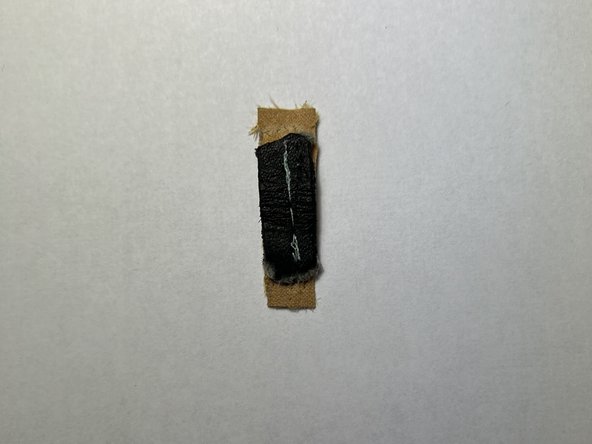

    • Use a sewing machine to sew the strap holder with the glued piece of fabric in the center.
    • If you have good sewing skills, you can sew on both sides.
  6. Briefcase Strap Holder Replacement: crwdns2935265:06crwdnd2935265:01crwdnd2935265:02crwdne2935265:0 Briefcase Strap Holder Replacement: crwdns2935265:06crwdnd2935265:02crwdnd2935265:02crwdne2935265:0

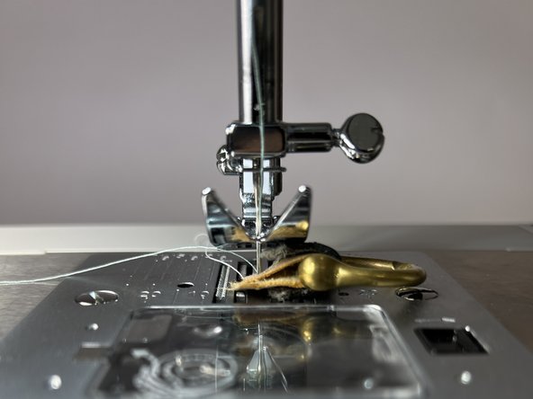

    • Place the metal strap holder between the leather strap holder and fold it.
    • Use the sewing machine to sew the tips of the fabric that was glued on the leather strap holder.
    • If your metal strap holder is openable, sew without the metal strap holder.
  7. Briefcase Strap Holder Replacement: crwdns2935265:07crwdnd2935265:01crwdnd2935265:02crwdne2935265:0 Briefcase Strap Holder Replacement: crwdns2935265:07crwdnd2935265:02crwdnd2935265:02crwdne2935265:0
    • Add more glue between the fabric and the leather strap holder to strengthen it and hold it while it dries.
  8. Briefcase Strap Holder Replacement: crwdns2935265:08crwdnd2935265:01crwdnd2935265:01crwdne2935265:0
    • Trim the area where the strap holder is placed.
  9. Briefcase Strap Holder Replacement: crwdns2935265:09crwdnd2935265:01crwdnd2935265:03crwdne2935265:0 Briefcase Strap Holder Replacement: crwdns2935265:09crwdnd2935265:02crwdnd2935265:03crwdne2935265:0 Briefcase Strap Holder Replacement: crwdns2935265:09crwdnd2935265:03crwdnd2935265:03crwdne2935265:0
    • Add glue with a glue gun to the area where the strap holder is placed.
    • Place the strap holder in the strap holder area of the bag and hold it while it dries.
    • It is recommended to sew the strap holder fabric to the area where it will be placed.
