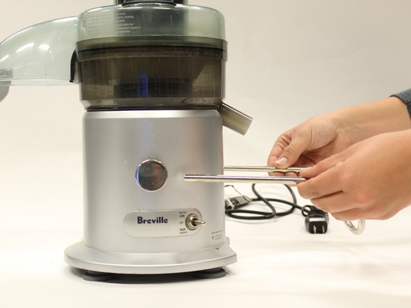

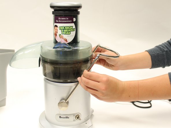

  4. Breville JE98XL Juice Fountain Plus Safety Locking Arm Replacement, Safety Locking Arm: crwdns2935265:04crwdnd2935265:01crwdnd2935265:02crwdne2935265:0 Breville JE98XL Juice Fountain Plus Safety Locking Arm Replacement, Safety Locking Arm: crwdns2935265:04crwdnd2935265:02crwdnd2935265:02crwdne2935265:0
    • Place one hand on either side of the safety locking arm.
    • Disengage the locking mechanism by pulling down on the lever with even pressure. The lever should be free to move up or down once it has been properly disengaged.

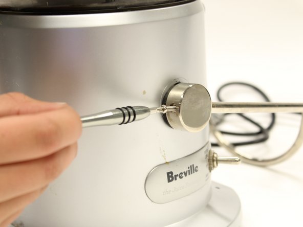

  5. Breville JE98XL Juice Fountain Plus Safety Locking Arm Replacement: crwdns2935265:05crwdnd2935265:01crwdnd2935265:02crwdne2935265:0 Breville JE98XL Juice Fountain Plus Safety Locking Arm Replacement: crwdns2935265:05crwdnd2935265:02crwdnd2935265:02crwdne2935265:0
    • Locate the two 1 inch Phillips #1 screws on the back of the safety arm.
  6. Breville JE98XL Juice Fountain Plus Safety Locking Arm Replacement: crwdns2935265:06crwdnd2935265:01crwdnd2935265:02crwdne2935265:0 Breville JE98XL Juice Fountain Plus Safety Locking Arm Replacement: crwdns2935265:06crwdnd2935265:02crwdnd2935265:02crwdne2935265:0
    • Remove the safety locking arm by gripping both sides and pulling horizontally away from the juicer.
