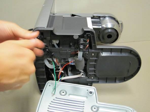

    • Use a Phillips #0 screwdriver to remove the following ten screws:
    • Four 18mm Phillips screws.
    • Four 9.75mm Phillips screws.
    • Two 8mm Phillips screws.
    • The cover will not remove entirely. Keep green ground wire attached to the cover.

  3. Breville BKC600XL On/Off Switch Replacement, Bottom Cover #2: crwdns2935265:03crwdnd2935265:01crwdnd2935265:02crwdne2935265:0 Breville BKC600XL On/Off Switch Replacement, Bottom Cover #2: crwdns2935265:03crwdnd2935265:02crwdnd2935265:02crwdne2935265:0
    • Use a Phillips #0 screwdriver to remove the following six screws:
    • Six 14.5mm Phillips screws.

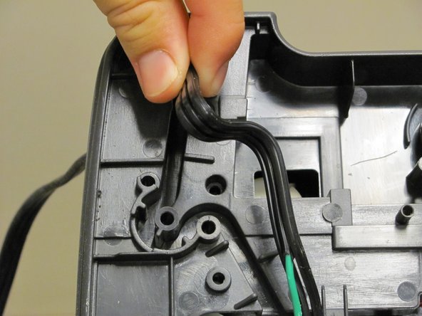

  4. Breville BKC600XL On/Off Switch Replacement, Power Cord: crwdns2935265:04crwdnd2935265:01crwdnd2935265:02crwdne2935265:0 Breville BKC600XL On/Off Switch Replacement, Power Cord: crwdns2935265:04crwdnd2935265:02crwdnd2935265:02crwdne2935265:0
    • Remove the power cord from the groove. (the black cord that leads into the green wire.)
    • This creates more slack in the wire to give you more room to work with.
    • DO NOT remove green wire from the cover its attached to.
