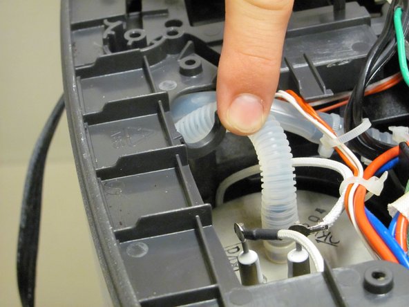

  5. Breville BKC600XL Heating Tank Replacement, Clear Hose: crwdns2935265:05crwdnd2935265:01crwdnd2935265:02crwdne2935265:0 Breville BKC600XL Heating Tank Replacement, Clear Hose: crwdns2935265:05crwdnd2935265:02crwdnd2935265:02crwdne2935265:0
    • Identify the hose that connects to the heating tank. (Observe that it is held up on a small hook.)
    • Push down on the hook and carefully move the hose from its grip.
  6. Breville BKC600XL Heating Tank Replacement, Heating Tank: crwdns2935265:06crwdnd2935265:01crwdnd2935265:01crwdne2935265:0
    • Carefully pull out the heating tank by hand.
    • The heating tank may still be hot. Exercise caution when grabbing hold of the tank. If necessary, wait four to six hours after last use.
    • Reminder for reassembly; You will need a new band to tie the hose back to the heating tank.
