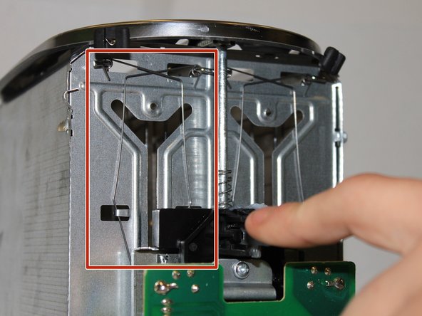

    • Turn the toaster upside down.
    • Remove the five 6 mm screws with a Phillips #2 screwdriver.
  2. Brentwood TS-292B Bread Grabber Spring Replacement: crwdns2935265:02crwdnd2935265:01crwdnd2935265:02crwdne2935265:0 Brentwood TS-292B Bread Grabber Spring Replacement: crwdns2935265:02crwdnd2935265:02crwdnd2935265:02crwdne2935265:0
    • Grasp the plastic pull lever cover firmly and pull to remove it. This may require force.
    • Lift the cover upwards to remove it.
    • When removing the cover, do not damage the cable connector bundle that attaches the cover to the toaster.
  3. Brentwood TS-292B Bread Grabber Spring Replacement: crwdns2935265:03crwdnd2935265:01crwdnd2935265:01crwdne2935265:0
    • To detach the bundled cable connector, carefully pull it away from the circuit board.
  4. Brentwood TS-292B Bread Grabber Spring Replacement: crwdns2935265:04crwdnd2935265:01crwdnd2935265:02crwdne2935265:0 Brentwood TS-292B Bread Grabber Spring Replacement: crwdns2935265:04crwdnd2935265:02crwdnd2935265:02crwdne2935265:0
    • Pull the toaster lever down.
    • While holding the toaster lever down, use the spudger to pull the metal tabs away from the wired bread grabber.
    • Continuing to hold the toaster lever down, pinch the wires inward and pull up to carefully remove them from the toaster.
