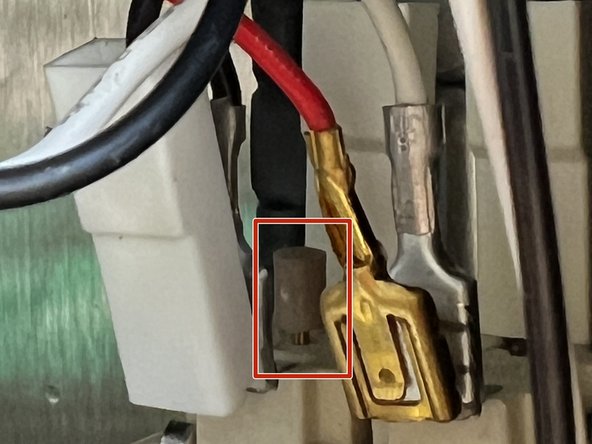

  2. Bravilor Bonamat THa Err 11, Locate the thermo fuse: crwdns2935265:02crwdnd2935265:01crwdnd2935265:02crwdne2935265:0 Bravilor Bonamat THa Err 11, Locate the thermo fuse: crwdns2935265:02crwdnd2935265:02crwdnd2935265:02crwdne2935265:0
    • Did you remember to pull out the power lead ?
    • Locate the metal cylinder inside. This is the heating core. The thermo fuse and reset button is located on top behind the power leades. Did you really disconnect power ?
    • Reach in from the left side behind the power leads and push lightly on the little button marked with red in picture 2. You will feel a little snap and a little movement if it resets.
    • If nothing happens, then your problem lies elsewhere. I am really sorry.
