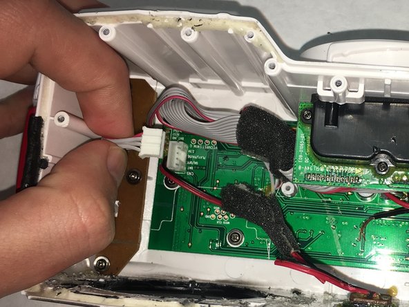

  10. Braven BRV-X Button Module(s) Replacement: crwdns2935265:010crwdnd2935265:01crwdnd2935265:02crwdne2935265:0 Braven BRV-X Button Module(s) Replacement: crwdns2935265:010crwdnd2935265:02crwdnd2935265:02crwdne2935265:0
    • Disconnect the ribbon cable attached the main board.

  13. Braven BRV-X Button Module(s) Replacement, Button Module(s): crwdns2935265:013crwdnd2935265:01crwdnd2935265:02crwdne2935265:0 Braven BRV-X Button Module(s) Replacement, Button Module(s): crwdns2935265:013crwdnd2935265:02crwdnd2935265:02crwdne2935265:0
    • Remove the ribbon cable attached to the main board.
    • Pull from the clip and not from the cable.
