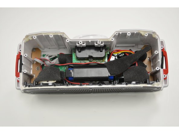

  4. Braven BRV-X Battery Replacement, Battery: crwdns2935265:04crwdnd2935265:01crwdnd2935265:01crwdne2935265:0
    • Remove the black foam squares from the red, yellow, and black wire on the top right side of the device.
  5. Braven BRV-X Battery Replacement: crwdns2935265:05crwdnd2935265:01crwdnd2935265:03crwdne2935265:0 Braven BRV-X Battery Replacement: crwdns2935265:05crwdnd2935265:02crwdnd2935265:03crwdne2935265:0 Braven BRV-X Battery Replacement: crwdns2935265:05crwdnd2935265:03crwdnd2935265:03crwdne2935265:0
    • Now that the three wires are exposed, follow the wires to the white base that is plugged into the motherboard.
    • Using the tech knife, carefully remove the glue that keeps the plug in place.
    • Using the tweezers, carefully disconnect the plug from the motherboard.
    • WARNING: Make sure the battery is drained of all power for safety reasons.
    • There should still be a small white base attached to the motherboard, where the plug will eventually be plugged back in.
  6. Braven BRV-X Battery Replacement: crwdns2935265:06crwdnd2935265:01crwdnd2935265:01crwdne2935265:0
    • The battery's black shell is connected to the motherboard with four screws. Use the #00 Phillips screwdriver to remove the four screws.
    • The screws near the speaker side of the device will be a tight squeeze to get to.
  7. Braven BRV-X Battery Replacement: crwdns2935265:07crwdnd2935265:01crwdnd2935265:01crwdne2935265:0
    • Now, you should be able to lift the battery along with the black container up.
    • Pull the battery pack straight out so you do not damage other wires or the motherboard.
  8. Braven BRV-X Battery Replacement: crwdns2935265:08crwdnd2935265:01crwdnd2935265:01crwdne2935265:0
    • Slide the blue battery out from the black container. Your battery is now removed from the device and is ready for replacement.
