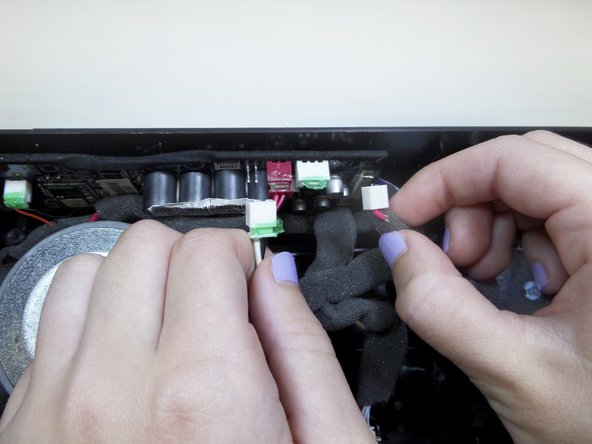

  14. Braven BRV-HD Speakers Replacement, Speakers: crwdns2935265:014crwdnd2935265:01crwdnd2935265:02crwdne2935265:0 Braven BRV-HD Speakers Replacement, Speakers: crwdns2935265:014crwdnd2935265:02crwdnd2935265:02crwdne2935265:0
    • Locate the two wires that connect the right speaker to the motherboard.
    • Gently disconnect the wires from the motherboard.

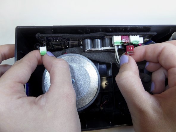

  15. Braven BRV-HD Speakers Replacement: crwdns2935265:015crwdnd2935265:01crwdnd2935265:02crwdne2935265:0 Braven BRV-HD Speakers Replacement: crwdns2935265:015crwdnd2935265:02crwdnd2935265:02crwdne2935265:0
    • Locate the two wires that connect the left speaker to the motherboard.

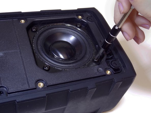

  16. Braven BRV-HD Speakers Replacement: crwdns2935265:016crwdnd2935265:01crwdnd2935265:02crwdne2935265:0 Braven BRV-HD Speakers Replacement: crwdns2935265:016crwdnd2935265:02crwdnd2935265:02crwdne2935265:0
    • Position the device facing up and remove eight 10mm Phillips head screws using a J1 Phillips head screwdriver.

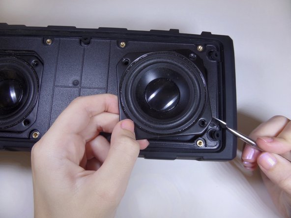

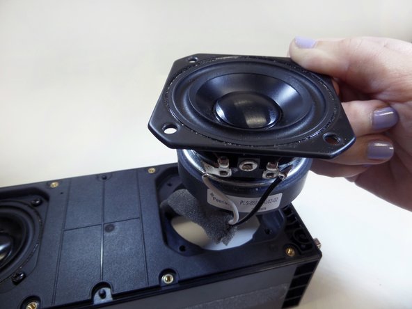

  17. Braven BRV-HD Speakers Replacement: crwdns2935265:017crwdnd2935265:01crwdnd2935265:03crwdne2935265:0 Braven BRV-HD Speakers Replacement: crwdns2935265:017crwdnd2935265:02crwdnd2935265:03crwdne2935265:0 Braven BRV-HD Speakers Replacement: crwdns2935265:017crwdnd2935265:03crwdnd2935265:03crwdne2935265:0
    • Lift the speaker out using the metal spudger and complete lifting by using your hands.
    • Remove the speakers with your hands and replace with new ones.

Where can I find a replacement speaker?
dillon0987 - crwdns2934203:0crwdne2934203:0
Peerless by Tymphany PLS-65F25AL01-02
