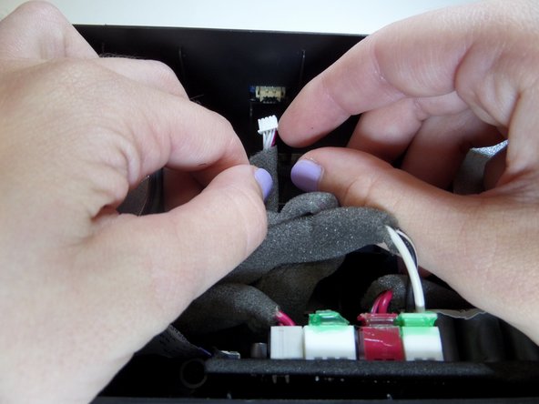

  13. Braven BRV-HD Power Button Replacement: crwdns2935265:013crwdnd2935265:01crwdnd2935265:01crwdne2935265:0
    • Disconnect the wire attaching the battery to the motherboard.
    • There is green glue on the wire ports preventing the wires from falling out. Peel and remove this glue as necessary.
    • Be careful when pulling out the wires from their ports. The metal stems attached to the ports can break. A spudger or tweezers may help.

  15. Braven BRV-HD Power Button Replacement: crwdns2935265:015crwdnd2935265:01crwdnd2935265:02crwdne2935265:0 Braven BRV-HD Power Button Replacement: crwdns2935265:015crwdnd2935265:02crwdnd2935265:02crwdne2935265:0
    • Unplug the wire on the inside of the device that connect to the button panel.
    • The wires are fragile. Do not use excessive force when unplugging the wires from the panel.
